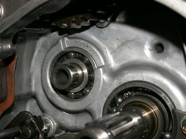

This is from a 97 motor. Guy that sold me the motor said it was fine.
I pulled the clutch cover. The basket looked good but moves up and down almost 1/4 inch.
Notice the lack of ball bearings on the cltuch shaft bearing and the crack coming from the other bearing.

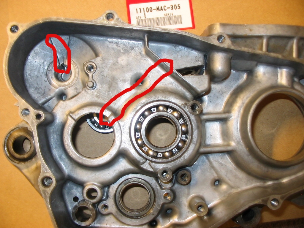

it starts at the kicker, a backfire and you stop it with your boot or something along those lines, i see the tab that holds the kicker spindle is cracked too, all goes together, look on the outside of the lump where the kicker spindle pilots its likely cracked there too, ontop by the vent hose if the bearing crack went that far, and in the oil slot on the kicker spindle, think i sent this pic, but here ya go
its possible it was a backfire, those can break the whole assembly loose of the case. But what would have caused the bearing failure? Two different issues?
That's when they decide to sell it to some poor unsuspecting SOB.dannygraves wrote:are the balls in with the oil or completely missing? No one misses ball bearings coming out with an oil change.
exactly!MojoScojo wrote:That's when they decide to sell it to some poor unsuspecting SOB.dannygraves wrote:are the balls in with the oil or completely missing? No one misses ball bearings coming out with an oil change.
