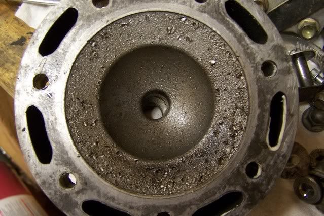

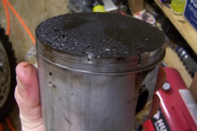

I rode a whole weekend in dumont with the top end looking like this....
So to sum it up I had a bearing in the tranny coming apart, a gear trashed a wasted crank and a destroyed top end AND SHE WAS STILL RUNNIN TITS Gotta love hondas
Last time i looked at my piston it didnt look like that and i have only run it quick around the block so i doubt my head and piston have damage like that.. Ill get it apart this next weekend with Danny and get stuff ordered that needs to be ordered

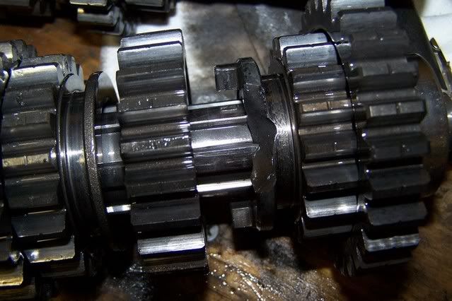

so danny took apart my motor this morning.. and 2 of the gears are all pitted up and chewed up.. however the meshing gears on the countershaft are pretty much untouched and brand new looking.. We kinda scratched our heads for a while and came to the conclusion.
A) the cases have been swapped
b) someone blew up a previous tranny in this thing
c) someone used old parts thinking they would be fine and apparently arent
So all new seals and bearings and im crossing my finger that Mike over at TT has the 2 gears i need in that spare box of parts he has so it wont cost me an arm leg and my first born.. Those 2 gears cost at or above 60 bucks a pop.. UGG..
yeah, the stator side case has the sticker, so we know it has been replaced and some of the gears have the tooth # writted on the side of them in sharpie.
