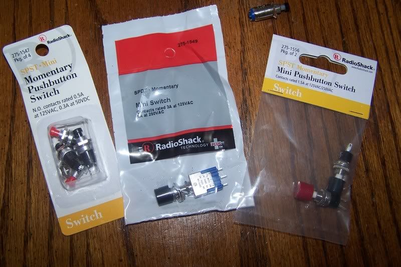

Heres some diff switches I ordered to try...
The one with the biggest spring of the lot next to the sticky one I was using, also had an audible click when you hit it....

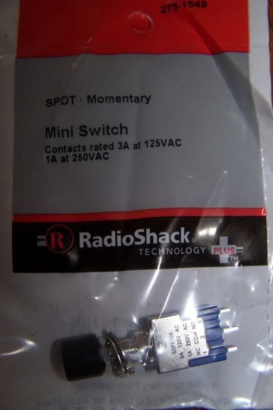

Better pic for the part #s...

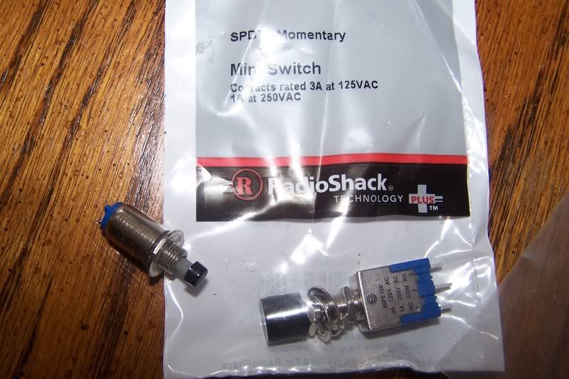

I ended up removing the plastic push part and shortening the switch untill it was flush with the throttle housing when WOT and activated.
Works bitchin so far and hopefully no more soiled shorts due to nitrous being stuck on :D :D :D
those look big
The one im using is bigger than the sticky one, but you can really feel the amount of pressure it takes to compress the internal spring. I think its a ton less likely to stick due to a bit of sand.
