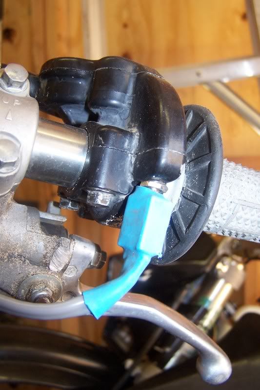

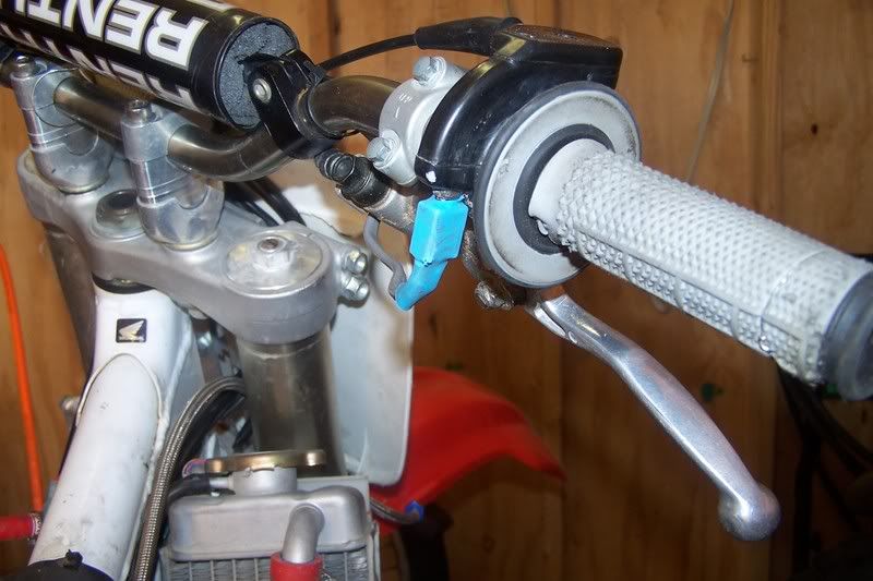

The thread size is not the same as the ones I got from slomas, its a little bigger. The hardware store had nothing close so I used a drop of 5 ton epoxy and glued it into the throttle housing.

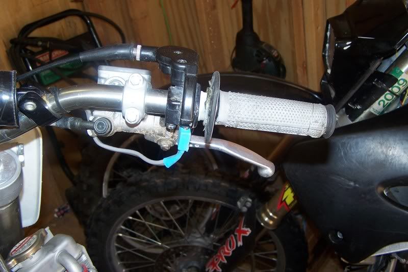

I ended up removing the plastic push part and shortening the switch untill it was flush with the throttle housing when WOT and activated.
Works bitchin so far and hopefully no more soiled shorts due to nitrous being stuck on
