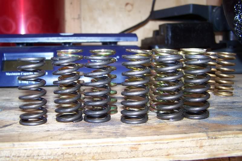

I dont think the friction or the steels are an issue with them I think its the springs, when new they are shorter than the barnetts and eventually they sag causing sudden death.
Heres a comparison of length, EBC heavy springs in front barnett in the back....

britincali wrote: Heres a comparison of length, EBC heavy springs in front barnett in the back....
Also measure the wire thickness, aftermarkets are a few thou thicker.
