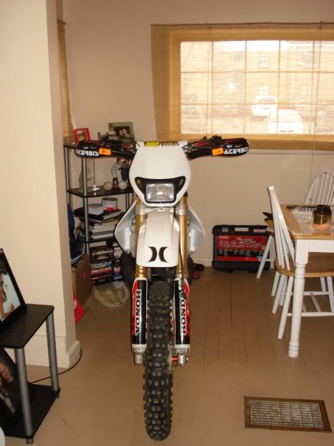

Here is my bike...It has been in my apartment all winter so dont mind all the other stuff in the background... :lol:

UFO plastics with headlight and taillight.
Acerbis handguards with integrated signal lights.
Ebay handlebar lighting/signal switches from Peak Motors.
Say hallo to my little friend, Mr. CR 500.

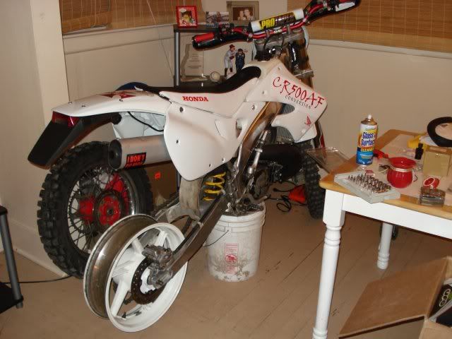

maybe you have seen my thread on supermotojunkie.com I am having a CBR600 F2 17" mag rear wheel machined down to fit in the swingarm. It is white...I will get a either a 150 or 160 tire for it and probably just put an enduro tire on the front and leave it for everything.

Stay with a 150 for a F2 wheel. slide the forks up till they just about hit the bars if your using the stock front wheel

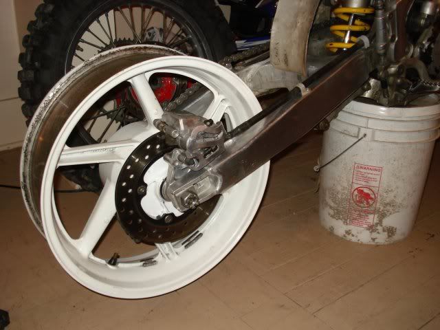

Here is the bike with the rim on it...the rotor is the exact same size...just a bit thicker :cool:
The rim doesnt have the cush drive on it right now...just fit testing it.
I will have the inner part of the cush spun down and the outer part of the rim that connects to the cush spun down...that way I can keep the cush drive intact...anyone have a 520 sprocket that fits a CBR rim? :D

getting the rim to fit is one thing but getting the tire to fit is another. now i dont know about the cr500 swingarms but i can tell ya you will be hard pressed to get anything larger than a 160 back there on a crf450 swingarm.

I took the wheel into my uncle to have him machine it. I will be getting a tire on thursday and hopefully I can have the right sprocket on its way to me this week. I will post pics of what needed done etc...I got all my wiring hooked up and hopefully I will start my bike today to make sure everything is working correctly.

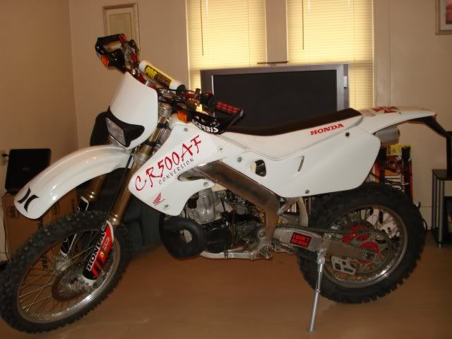

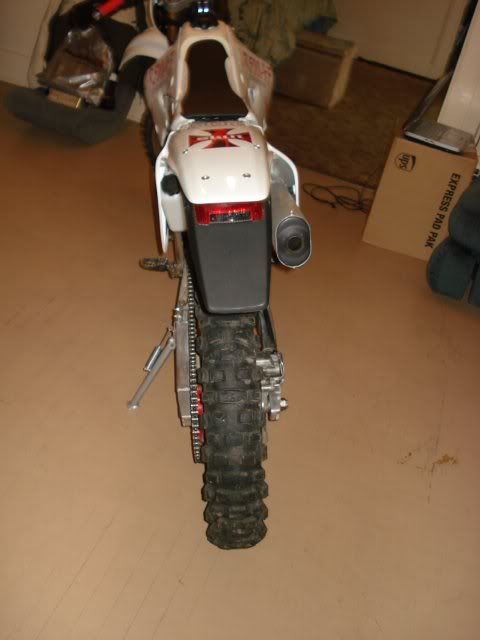

Bike started up and runs great. light works too. Signal lights arent flashing though, they just stay on, do I need to get a flasher or something? I thought the handlebar switches would control that but I was wrong. It still goes from dim to bright though with RPMs but I guess that is to be expected.

You need a flasher to make the signals work. You can get them here for l.e.d or regular bulbs. http://www.procycle.us/main/dskit.htm

thanks for the link! I'll get pics up on monday...my uncle just called me and said that he has run into a small problem but he says it is within 1/4" of where it needs to be compared to my paddle wheel. I know it can be that much wider distance between the sprocket and rotor because the caliper moves too so it might be just right.
