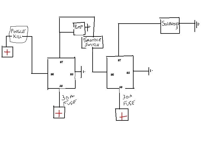

Im gonna wire my nitrous tonight and insted of using the one relay that came with the kit Ive bought another so the pingle kill switch isnt gonna have to be turning the pump on and off.
I came up with what I think will work, all sparkys please speak up!
Dont laugh I did it on paint this morning :oops:

Why deviate from the intended design?
I don't see any reason why your drawing wouldn't work either.
The pic I show has your throttle switch providing a ground for the relay, where as yours is going to have power going through it. It takes more amperage to open the nitrous solenoid because of the pressure against it.
Make sure your switch will handle the amperage.
I grounded all of my ground wires to the factory ground point also.
The only load the throttle switch is going to see is the 100 or so milliamps to trigger the second relay (I think...)

slomas wrote:Why deviate from the intended design?
I really dint like the pump running through that ($120 :shock: ) pingle switch, its bound to fry at some point.

britincali wrote:The only load the throttle switch is going to see is the 100 or so milliamps to trigger the second relay (I think...)
Ahhh- your right.... I stayed up way too late last night and drank WAY too much beer. Yes, it is possible to drink too much beer. :blur:
Carry on!

It will work Brit!
There is lots of ways to wire that circuit.
I don't know anything about NOS setups so does the fuel pump have to be on before the solenoids kick in or can it be turned on with the solenoids? Also how much current does the pump pull?
Because if it can come on with them and doesn't pull alot of current then you could still get away with just using one solenoid!
You're an electrical engineer now brit? Don't be second guessing the designers dude. I think I'd be for trusting the Pingel over some $5 toggle as shown on the intended drawing. And if the engineers trusted a toggle....
In Slomo's example, if either the relay or microswitch fails in the closed position...your going for quite a ride. I doubt your getting your fingers on that toggle.
In Brits example, you have 2 methods to shut the thing down ( Pingle and microswitch)

Why not just insert the Pingel after the fuel pump and before terminal 86 in Slomo's example? That way you have 3 ways to shut her down, only 1 relay and you're not running the fuel pump through the Pingel.
I still think it makes more sense to just run the Pingel in series with the toggle so you run the fuel pump off the Pingel and not mess with another relay. The simplest solution is usually the most failsafe.
I went to the Pingle website to get the stats on the amperage their switch can handle...
Not published...
:cry:
AlisoBob wrote:I went to the Pingle website to get the stats on the amperage their switch can handle...
Not published...
:cry:
I cant see it being much.....
Just got off the phone with tech support at pingle and its a max 6 amp rated switch.
Last edited by britincali on November 26th, 2007, 12:41 pm, edited 2 times in total.
Your gonna' need that relay then..
AlisoBob wrote:Your gonna' need that relay then..
Thats why its already wired in :wink:
From what Ive read those little pumps use between 2 and 4 amps to run, that dosnt take into account the starting requirement, Ill bet thats another couple of amps easy.
That 6 amp rating is gonna be a continuous rating. Your inrush for starting a motor of that size is going to last maybe 1/10 of a second. Not an issue. I still think you're good to go.
It's your bike, and your safety we're talking about though.
MojoScojo wrote:. Your inrush for starting a motor of that size is going to last maybe 1/10 of a second. .
Its the spark thats created that eats switches.
A spark? At what, 12 volts?

MojoScojo wrote:A spark? At what, 12 volts?
Whatever.
You're thinking too much.
I dont think im over thinking this one, 12v will spark bigtime especially when you consider the amp draw at such low voltage.
You never accidently welded a wrench to a car?
Its not the low voltage, its the colapsing magnetic field of the solenoids and the high voltage they produce. It will arc somewhat across the relay. If you were doing this 100% correct, you would install some diodes to block this from eating the relay contacts ( over a long period of many cycles)
AlisoBob wrote: If you were doing this 100% correct, you would install some diodes to block this from eating the relay contacts ( over a long period of many cycles)
A relay is a hell of a lot cheaper than the pingle.
We're not talking about running the solenoid through the pingle. We're talking about the fuel pump. Like I said, if you don't want to run the fuel pum through the Pingel, then run it through the toggle and put the Pingel in series between the toggle and the relay after the fuel pump. But using the Pingel to cut off the fuel supply is, by far, the SAFEST solution. You're worried about the life expectancy of $100 part over your own safety. Foolish if you ask me. The conditions your talking about will easily take many YEARS to occur. You can get hurt in a HEARTBEAT.
