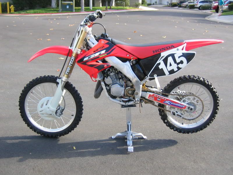

Pecker is Ryan Cepek
http://www.bannedcr500riders.com/board/ ... php?t=4779
Stock CR125 pipe clearence
Same bike after CR500 conversion with P/C S/H 2004 L/E pipe
