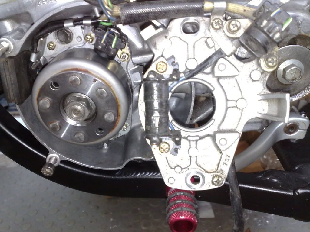

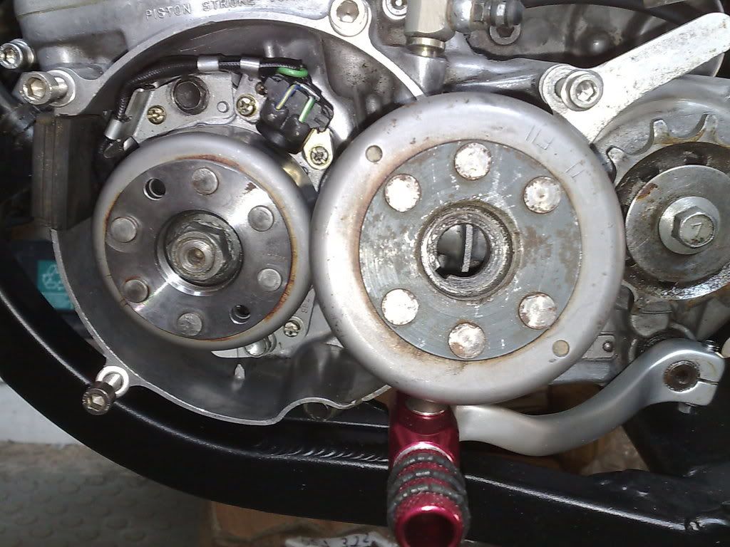

Sorry about the delay.
1st picture shows the 250 flywheel & stator plate fitted with the 500 flywheel along side it.
The second shows why you can't use a 250 flywheel with a 500 stator plate assembly.
Ugly

thnx man that bitchin information. thats '01 cr250 hardware right ? do you happen to know what the weight difference was ? im for sure getting that setup for my machine. how does your bike run with it ?ugly1171 wrote:Sorry about the delay.
Ugly
I'm ashamed to say, due to a new job & other commitments, the bike is on the back burner at the minute so i've not ran it up yet, got to modify the fuel tank to clear the plug & cylinder head bracket. I just checked i had a spark at the plug.
Ugly

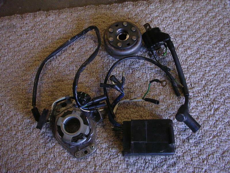

I just bought this off DesertCR for $90 to my door.
It's a complete '94 CR250 ignition. The '94-'96 shared this equipment and now Honda has stopped production of the '93 system
so this ignition has replaced it as well. It's not digital like I had planned on, but I thought it would work well regardless. And for
the money can't complain if I don't like it...
Very excited to get my new present
