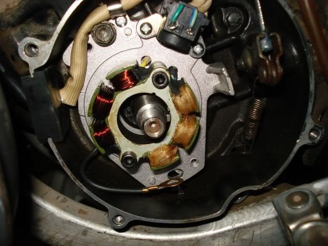

So, this might be a retarded question but the CR250 ignition (stator) I am putting on my bike has a ground wire. Is it supposed to run to the stator plate mounting bolt? Will it be ok if I do that? Just wanted to make sure since the 500 stator doesnt have one on it.
Say hallo to my little friend, Mr. CR 500.
Thats exactly what I would do.

Post by Caseys500 »
britincali wrote:Thats exactly what I would do.
Great...thanks brit. I guess I should ask if your bike still works though! :P

Caseys500
Posts: 125
Joined: February 7th, 2008, 8:40 am
Location: Idaho
Post by Caseys500 »
ou812 wrote:
who else is running thi? is this a better setup that the 500 cdi? what is involded in the swap.
IMO best to not bit off more then you can chew. Get your bike finnished ride it a while, get to really know it, the last mod you want to make is ignitions off other models, you can burn holes in the piston pretty quick if you don't have a good feel for how it is reacting to a ignition mod.
Couldn't have said it better myself...I made sure my bike was running good before I started this swap. I got everything...the flywheel, stator and CDI. This is all from the same year range too, the 89-92 CR250.
I happened to get lucky and they are all from a 1990. The wire colors are a little different so I have been trying to make sure I get everything lined up right before I try to fire her again. I also am putting all the wiring in for it to be street legal so it may take me a while. especially since I have broken a connector or 2 that I now need to fix.
Although I like what I hear about the increased performance, I am doing this as an upgrade for the lighting capabilities. That way I didnt have to buy the stock stator, just the lighting one.
by the way...I also think that diff. ignitions affect how hot your engine runs because it makes the engine run differently ( higher revs and diff power ranges) Makes sense to me anyways

Post by LOVEMYCR500 »
Danny, after I read this thread yesterday I went and looked to see if my Dyna 4 curve 2001 CR 250 CDI box would plug in with no other mods (I have this on my TRX 250r) and I it's a totally different plug. Now I understand how you did it using a older style 250 CDI box. Are the late 80's ignition digital? I know that is one advantage to the newer years they became digital and have hotter spark. You have to buy stator,coil,flywheel though to run the new stuff. I have curve grafts for the 2001 ignition that came with my Dyna box (can't buy these anymore) but I wonder what the curve looks like for 88?
If I could figure out how to post, I would put these up
the '88 was still analog and basically all I had to change was to a '87+ coil and the one connector was a little different. I hear the digi ('97+) is the way to go though. you can use a higher wattage lighting coil and they had all sorts of new features with the digis to make more traction and create less wheel spin.

Post by Caseys500 »
Here is the lighting ignitions available from moose...
http://mooseracing.com/pdf/ignition.pdf
97-99 CR250 only 35W
04-08 is 75W.
I went with the 89-92 with 80W. I still need to get female bullet connectors to finish it up and try it out. I think I am gonna make sure it has spark before I put it all together to find out no worky.
