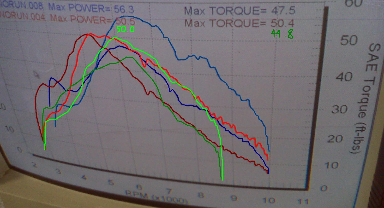

very peaky, takes the power 1000rpm higher, and after that did add 5.5hp, BUT the torque was down everywhere!
with no silencer we lost 18ftlbs from what the fatty had done and gained 4hp, with the silencer we only lost 3ftlbs but gained 5.5hp, it was still 1000rpm later.
at 10000 the cpi made 2hp more than my fatty at 10000

btw, this engine i put in sunday made 1hp more than my friday engine, but gained 7ftlbs of torqure, moved the delivery of both down 1000rpm, made it pull unbelievably smooth, extended the over rev from 8500 to 10000, and is good on fuel if my 5.5 hours of riding had anything to say.
The TTM bike from Team DNS will be running this porting.
the 39pwk made2hp more than the 41 right from the bottom, but the torque curve was 2-3 higher and wider with the 41, both peaking within .1 of eachother. They were both looking for the same jet, we couldnt do anything but take power away by messing with where i have it.
I foolishly didnt try the pc pr gnarly, but that'll be coming. I'm going to run my 86 engined '88 withthe gold series, bored pj, carbontech reed. the 2000 thats epoxy modded in the transfers,gnarly +vf2+bored pj, and the 1999 that bro rides thats stock with a pc pipe and shortened pc silencer. sometime in the next week or 2

stock port timing, stock port dimensions at the sleeve, both engines setup to achieve 0 deck, stock reeds, stock boot(blended to fit the 41carb) 88 250 ignition, fmf fatty pipe, fmf silencer. the green dyno is fridays engine, its an 87 based crankcase and a 89+jug with the sleeve cut down to fit the older cases. both have identical machined exhasut ports.
I wasnt chasing the biggest HP with this porting, looking for torque and to move it down in the rpm, did it, and the delivery is smooth like my 03 250, it doesnt rant, it doesnt give the big pipe shutter then start working, it yanks on you from everywhere
