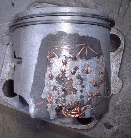

bwh998 wrote:
is that cylinder for sale, because i have the perfect piston to go in it:
what the hell did that come out of? from mexico? I seen a dude drop a valve in a 350, took the pushrods out and put a wooden "piston" in it and drove from mexico to canada!
