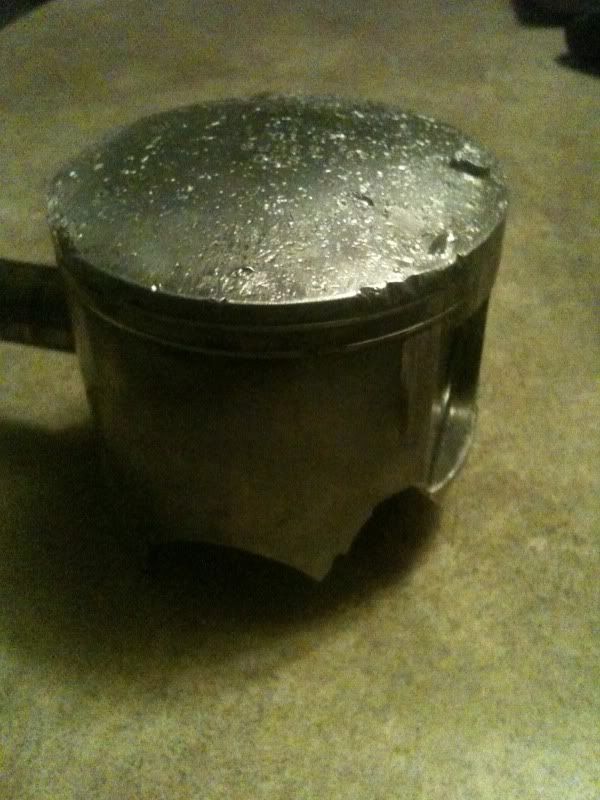

I just grenaded my top end finally, and it's time for a rebuild. My question is for you guys that are running Glenn's race port, how long do they last? I ride primarily open desert/dunes And need more top end but I don't want to sacrifice reliability (it was a long walk to the truck when this motor seized). Also what kind of fuel do you run? I can get 100 octane at the local 76 station, just wondering if they will run on that. I'm also considering the 250 ignition swap if I can find the parts.

Well shit that's good to hear. When I get this thing put back together we'll have to go for a rip brit, coppercity and calico are within a tank from my place. What pipe do you run? I need a new one. Got it pulled apart and the wiseco cracked a skirt and vaporized it into aluminum dust and melted it to the jug. Doh.

Out by the dry lake on the way to Irwin. I'm not sure why the wiseco busted up, but it made a mess when it did. 5th gear tapped~

Thats a weird place for it to break, you sure the crank isnt coming apart and a chunk of bearing dint cause that damage?

It could also be that the clearance got out spec and cracked/broke the piston.
You got anymore pics of that piston?

Just this one. It's weird it has hairline cracks all around the skirt and the pipe was coated in aluminum dust. The crank is tight, same with the rod. No play at all, smooth spinning by hand and no debris in the crankcase, most of it went out the pipe at WOT.

I usually run .006-.007, but the top ends get changed every 8-10 races and rings every 4-5. It's done that way to get the piston out before it cracks. If it gets run too long and cracks, it will look like the pic he posted.
