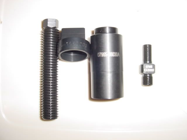

You can buy one of these to pull the crank into the cases. I have one but haven't used it yet.
http://www.rockymountainatv.com/product ... lyId=17166

HrcRacing wrote:[You can buy one of these to pull the crank into the cases.
This is the way to roll....

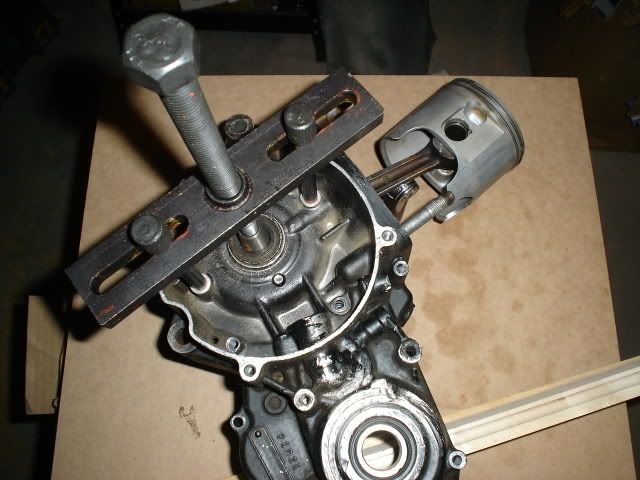

ok ill shut up because my memeroy is foggy but because theres bolt holes on both cases i think my puller was large enough to work on both sides, but i dont think a steering wheel puller will work for the right side case
100hp honda wrote:nobody said to beat it with a hammer. all i was saying was, i didnt even get a hammer out of the tool box
My bad. I'm going to have to buy one of those splitters to go with my puller. That splitter if frickin' sweet! :cool:
i wasnt being a smartass. serious, i can double check tomorow but im sure thats how i did it, the motion pro will screw into both side cases, requiring no tools but the splitter and wrench to tighten it

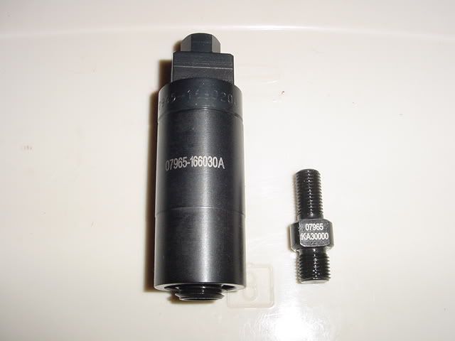

By "my bad" I meant that I was sorry for taking what you said the wrong way. I wasn't thinking that you were being a smartass or doubting what you're saying. I'm sure the Motion Pro tool works like the Tusk one in the video I linked and the picture I posted.

Here's the Motion Pro splitter. Basically, the same as the Tusk one but a "bit" more expensive. :wink:
i found this old photo of how i did mine my last one couple yaers ago. nothing beats rebuilding a engine in the kitchen :lmao:
