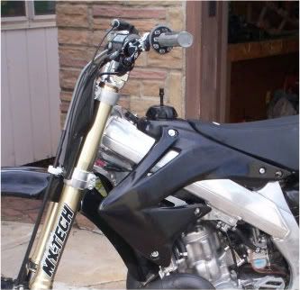

Before I parked my 450R framed beast for the winter I was feeling the bars sat too high using the standard triple, stock bar mounts, 1 1/8" adapters and the high RC 1 1/8" bars.
Decided to get a new 1 1/8" top clamp or whole triple clamp package. Was eyeballing a Pro Taper set up. and am most likely gonna go the whole package...
Throw out some experience or opinion between the stock 24mm, the 22mm and the 20mm offsets.

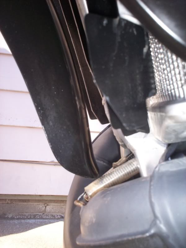

I guess that leads to another question. Does the offset move the bottom of the forks closer to frame or further out? I currently have mm's between my front fender and pipe.
I did have to trim about 1/8th of an inch off of the bottom of my fender to clear the pipe springs. Can be done with a file but I used a Dremel like tool and you can't really tell it's modified.
