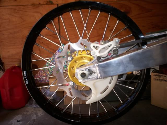

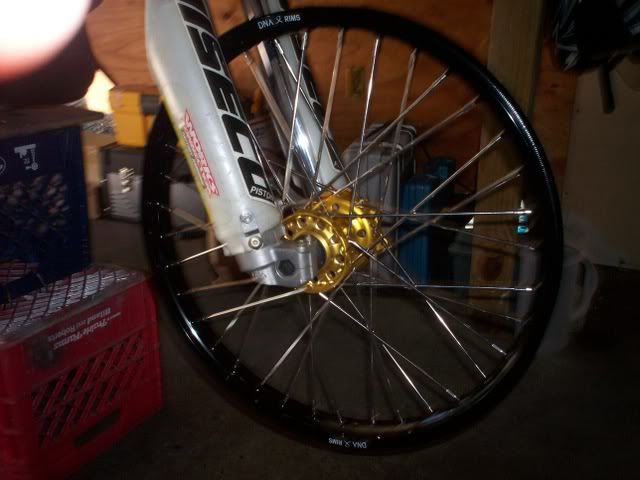

Woo Hoo... Got a load of goodies in today, forgot what it felt like to be a kid on Christmas
Wheels and disks look sweet as does the new SDG tall seat; wheels came with back disk and sproket bolts, but no front disk bolts
Tubes, rim strips, wheel locks and tire tools made it here too, tires will be here Thursday along with a new stand so I can retire the milk creats.....

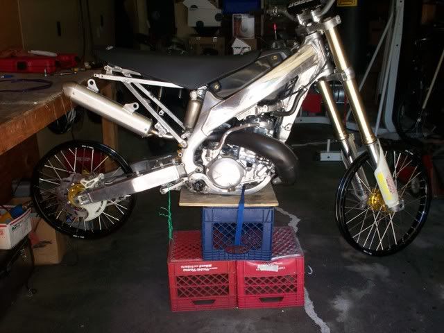

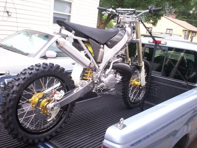

Made some major progress, almost looks like a bike now
New DNA wheels w/ new Starcross tires and ultra heavy duty tubes, dual wheel locks in back. Front disk bolts and right radiator will be in tomorrow, so I will be bringing this monster to life this weekend. Only thing left to order are the plastics, chain/sprokets and a front brake system

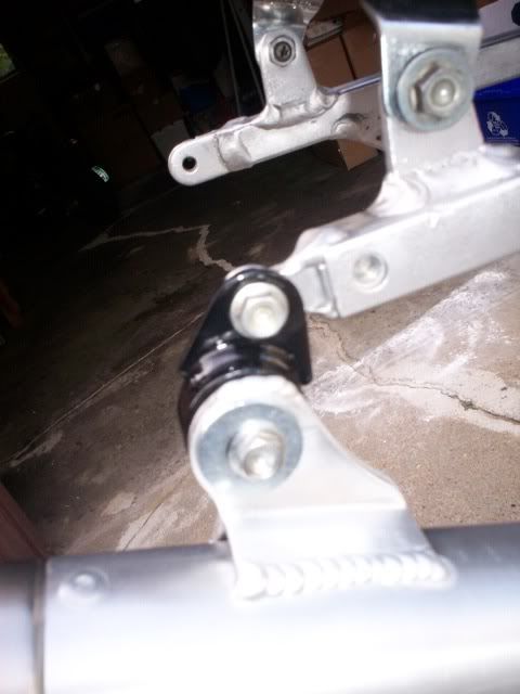

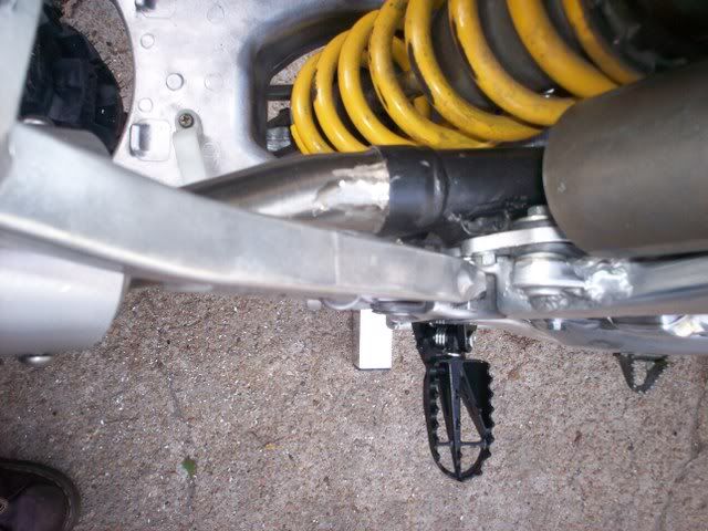

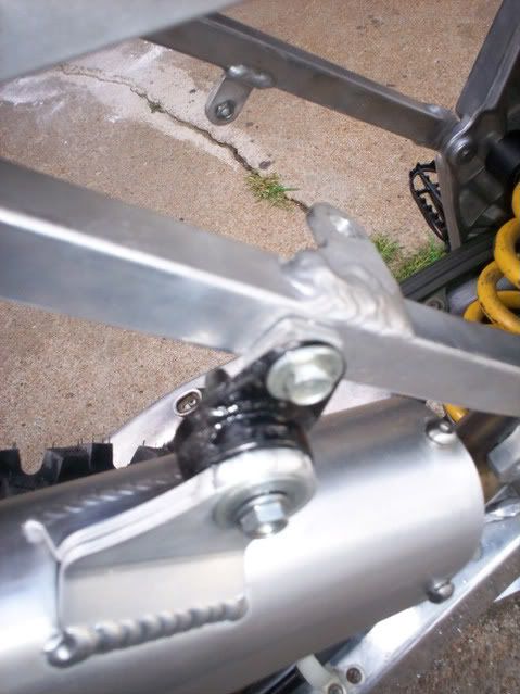

First I off seeing many smaller MX bikes with only one silencer mount have lose or sloppy exhaust systems, I think having 2 is important for this application; one may work, but what is a few mintues to fab up a mount. Just my 2 cents
Here are my silencer mounts, pipe was a little long for my application. Had to trim almost a half inch off the front part of the pipe where it slides into the expansion chamber. The mounts themselves are from a 86-89 TRX250R, had one back in the day and just new the mounts would work for this; so I got me a set off the bay. Had to use the back fender hole as the silencer is just a tad bit too long. The front mount is a hole drilled in the subframe an nutted insert pressed in (the old fuel valve mount I wacked off the frame
) . I am going take the subframe down Monday to have the front mount welded in and the old exhaust mount band sawed off, leaving only the number plate part of the mount. Also got a blingy clamp to seal the junction of the pipes, should look sweet.
Front mount
Back mount
Front mount
Back mount

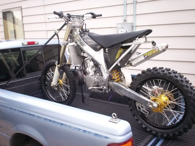

Got the new right radiator yesterday, was not happy with the way the lower cross over fit between the engine and frame; much different then the old bent leaky one
Decided to cut the cross over off and have it covered, chopped the top outlet off the old bent leaky rad and will have it welded on like in the pic. Hoped to have it running today, but this will make the whole build that much better. Time to search for a new cross over hose
Beast almost does not fit in the back of the Ranger

Thanks RobertCR500R-G3 wrote:Man, that looks great! What kind of hubs are those? They look sa-weet!
They are DNA wheels with JT Braking rotors. We will see how they hold up; heard mixed reviews, but nothing too bad.

They look awesome man. Looks like you're not lacking much to finish it now. Cool!eyesky2002 wrote:Thanks RobertCR500R-G3 wrote:Man, that looks great! What kind of hubs are those? They look sa-weet!![]()

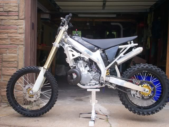

New chain and sprokets are on, as are the Works Connection radiator braces. Took it to my buddies and went for a couple spins around the field, runs and rides great and nothing fell off or came loose
Still waiting on the complete front brake system and the plastics are ordered and will be here Tuesday.
