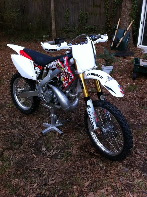

Wow, got to Ride around a bit yesterday and was easy on it since its new. Went to start it today and it completely shatter both right side covers from kick starting. Assuming it was the big compression. Is shattering these cases rare?? Not looking forward to pulling it all apart again after 15 minutes on it:([/youtube]

Relatively common failure. Well, maybe not common, but not rare.

MojoScojo wrote:Relatively common failure. Well, maybe not common, but not rare.
too much compression or do the cases just get weak over time?
It seems like 90% of the time its right after being rebuilt.

So I found a motor and am in the process of replacing the cases. Has anyone welded up another support bracket by the kickstart gear? Thinking of doing this
Jeff4510 wrote:Image
I wouldnt weld the cases.... if you want insurance against this happening again... get a decomp setup installed.

I had 1 very near fatality like that and 1 450x do something very similar check the kick start release tab that is bolted to the center case it cost like $2 bucks and if it breaks it sends the kicker into a forward direction under full engine power into the clutch case and the result is busted cases like your photo

So before I broke the cases I noticed I sometimes had some decent "kcikback" fron the kickstart. I am just curious, how many of you guys experience this? I am running the electrical from service honda so I am seeing if this is a timing issue potentially
id put money on the splines not being lined up properly....

That right there is the main reason I got the decomp setup....after claiming one kick lever already, I figure it will save me money and headache.

There is only one way to line up the splines... I've done some calling around and this seems to happen to modified motors. I took out both cases on the right side and I'm thinking it was due to the "kick back". Wish I could tell how it actually broke..

So it after close inspection it looks like the cases broke from the downforce not the kickback. I say this by looking at which way they actually cracked. I am going to design some gussets to support the kickstart ear on the case so this doesn't happen again. I'll post some pics when they're done

Here's the clutch cover brace almost done. You can see where it cracked on the case

you should see the back of the ear, nasty. The back brace will be a gusset type about 5 times the size of the stock gusset. I don;t want this to happen again. it also seems this is one of the weak parts of the design as it is an "ear" just hanging out in space with little support.

No offense, but if you are going to take the time to weld this all up and make gussets and everything why use a piece of metal that looks like it's been clawed by a very angry pair of vise grips. I believe Roosty has made this repair before and gussetted as well.
