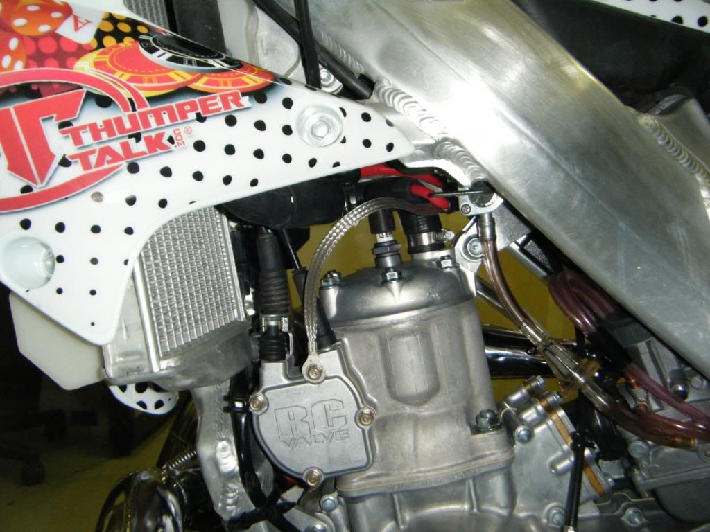

Here is what the stock setup looked like “before”:
The instructions warn against cutting any closer than 2 inches from the “capacitor” so I chose 3 for safety:

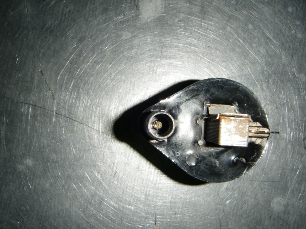

Unthread the stock wire and you will see what looks like a wood screw poking up:
I slipped a piece of heat shrink and the OEM boot on the end and then threaded the Nology wire in. Then shrunk it down and slipped the boot back into position:
Super simple and clean!

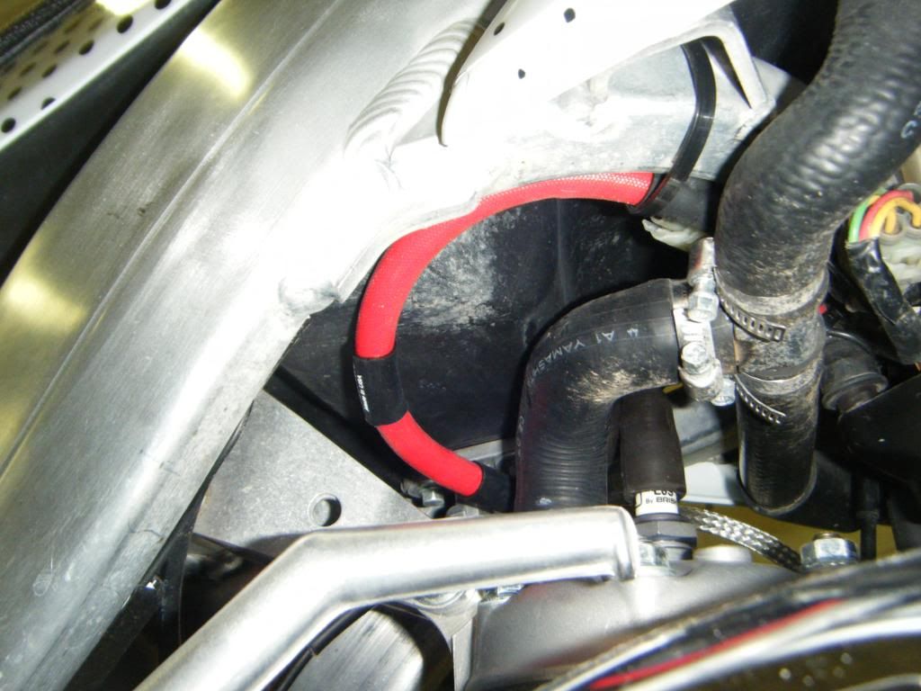

I routed the wire near the frame spar so I could zip tie it and keep everything clean and tidy:
The ground wire eyelet was the perfect size for the exhaust valve cover:
