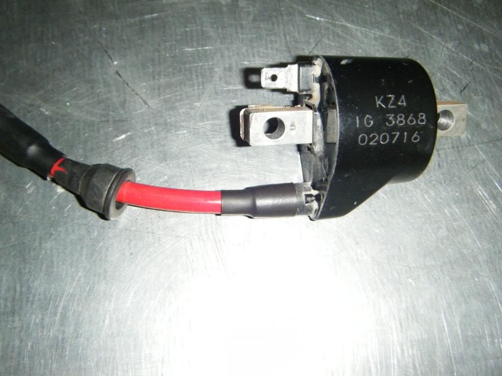

Here is what the stock setup looked like “before”:
The instructions warn against cutting any closer than 2 inches from the “capacitor” so I chose 3 for safety:

A little while back I sent my 03 CR250R cylinder head in for the "100 octane mod" changes. They fixed Honda's quench volume issues and also raised the compression. Right afterwards I started experiencing signs of weak ignition which wasnt a surprise as raising compression can quickly expose weakness in this area. I started looking into upgrading my ignition. First I started with the spark plug wire as this is a common issue on these bikes. After stumbling on Nology products in the Parts Unlimited catalog I called to ask some recommendations. They sent me a Nology wire and matching Nology Silver Plug. This combination made a substantial improvement but was not “optomized” due to the weak stock coil. Nology sent me their “ProFire” coil to try out and here is how the install went.

I was really impressed once I took the bike for a test ride. The first thing I noticed was how soon the bike would idle after being started. Its was well below 50 degrees at the time. On the stock ignition I would have to "keep the bike alive" for the first minute or two while it was on the choke. Then once the choke was shut off id have to once again blip the throttle for another minute or two before the bike would idle smoothly on its own. With the Nology setup the bike would idle almost immediately after it was started and only required a couple "blips" of the throttle after shutting off the choke. It sat and idled for 10 minutes just fine while I cleaned up my mess. The bike has never pulled through the rpms smoother than it does now and all signs of ignition issues are completely gone!
