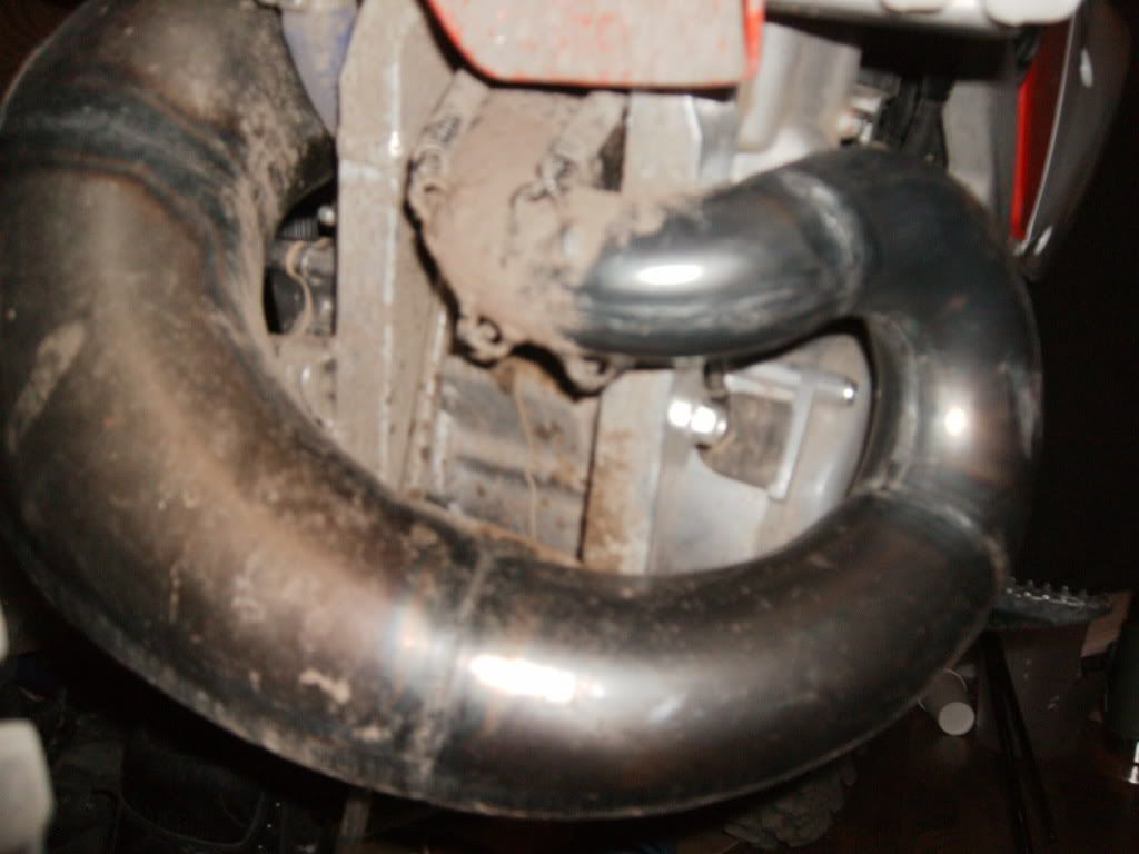

heres a pic of the pipe
is that really hot, or how far is it okay for the blue to get?
