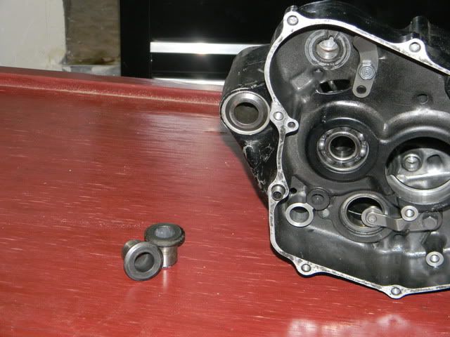

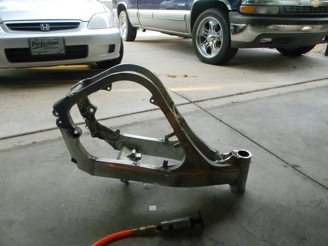

I had the 88' bushings removed and had the cases bored to accept the 17mm bushings From the 98' CR250 that came out of the donor frame.

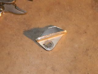

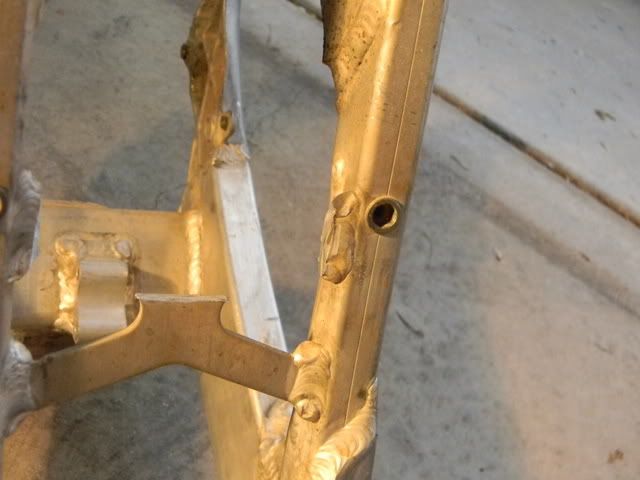

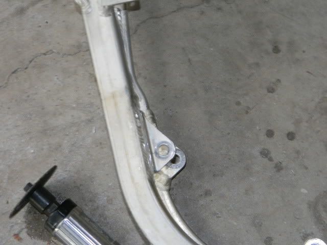

Time to take the plunge (you guys have to remember I'm a normal guy not a welder or fabricator) and start cutting the factory front engine mounts off!!!

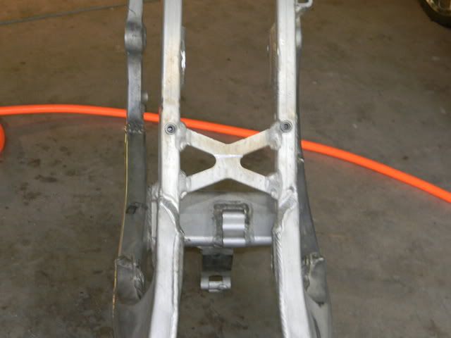

I am moving on to the X-Brace, I only cut the bottom portion of the X-brace. Honda engineered it to be there so I didn’t want to remove the whole thing.

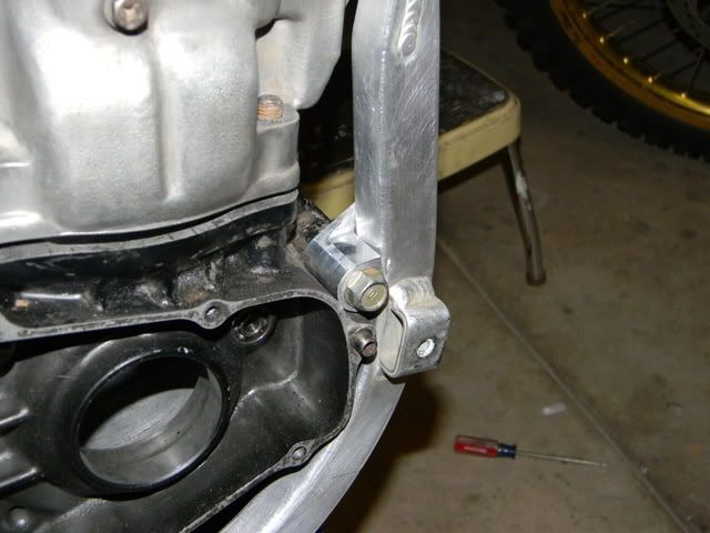

I removed the second engine mount and completely cleaned deburred and resurfaced one side and now on to the other side of the frame!!
Here are both sides completely cleaned deburred and resurfaced per Shanmans instructions.

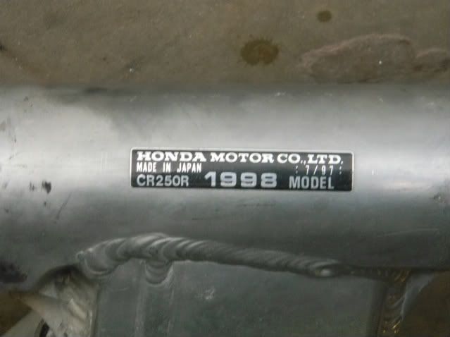

1998 CR250 Donor

1. I think guys are now using the correct OEM Honda bushings as they are cheaper to buy than having the Shanman spacers made.
Bob You wouldn't happen to know the OEM part numbers for the correct bushings or know a Hoon that would? Those bushings are a pain in the ass, I like astroids solution to the spacer but it would cost to mush to import them.
AFC Build link
The combined legnth of the 250 bushings + spacer are:AlisoBob wrote:I think you need a 54mm and a 59mm.
Something like that.
Whats the combined legnth of the 125 bushing + spacer?
Countershaft side- 55.98mm
Clutch side-54.00mm
The stock 98' CR250 both bushings are 49mm
I don't think a 56mm would work, right??? Is a 56mm even made in that length
Bob Do you think a machinist could mill down the 59mm to 56mm, I’ve heard that they are a hardened steel??
I was looking through the thread: Gen 3 OEM Swingarm Spacers and Washers.
CR500R7 wrote:OK this might save some confusion when stuffing a CR500 into these frames.
The Std CRF250 04-09 uses a 49mm on the left and a 59mm on the right, with the CR500 engine get a 54mm for the left side and you are done.
The Std CRF450 02-04 uses a 49mm on the left and a 54mm on the right, with the CR500 engine swap right to left and get a 59mm for the right side and you are done.
The Std CRF450 05-09 uses a 46mm on the left and a 54mm on the right, with the CR500 engine swap right to left and get a 59mm for the right side and you are done.
The Std CR125 02-07 uses a 54mm on the left and a 59mm on the right, with the CR500 engine you are good to go as is.
The Std CR250 02-07 uses a 49mm on the left and a 54mm on the right, with the CR500 engine swap right to left and get a 59mm for the right side and you are done.
Part# for the 54mm bush is 52142-KZ4-J40, left side of swingarm.
Part# for the 59mm bush is 52141-KZ4-J40, right side of swingarm.
If any of this is incorrect, please let me know so I can change it before any mistakes are made.

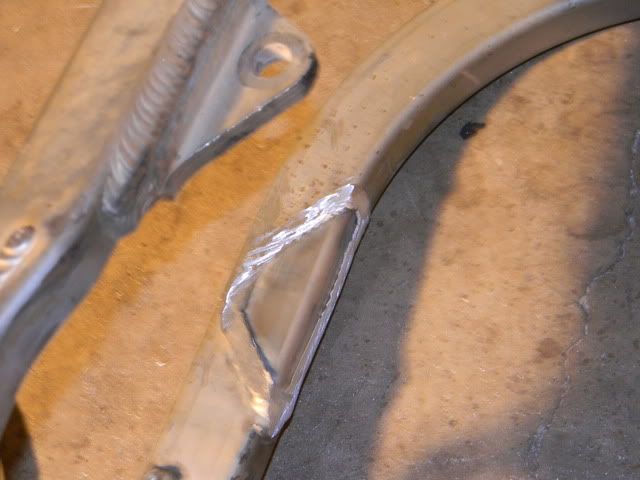

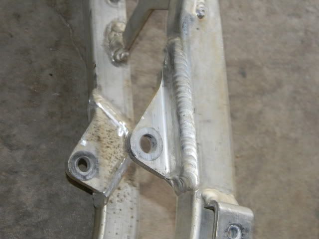

Getting her ready to take to my welder. Making sure everything fits just right.
Picked her up from the welder yesterday!!!
Don has many years of welding under his belt. What do you guys think??
AFC Build link
- AlisoBob
- "Hoon-father"
- Posts: 15404
- Location: Aliso Viejo Ca
Just grind down the 59mm to 56mm by youself, and your all set
THe 59mm just may squeeze in there as-is. The case bushings are beveled just for this reason... to coax it all together.
Welds look sweet.
Old goats know their way around a Tig torch....
Welds look sweet.

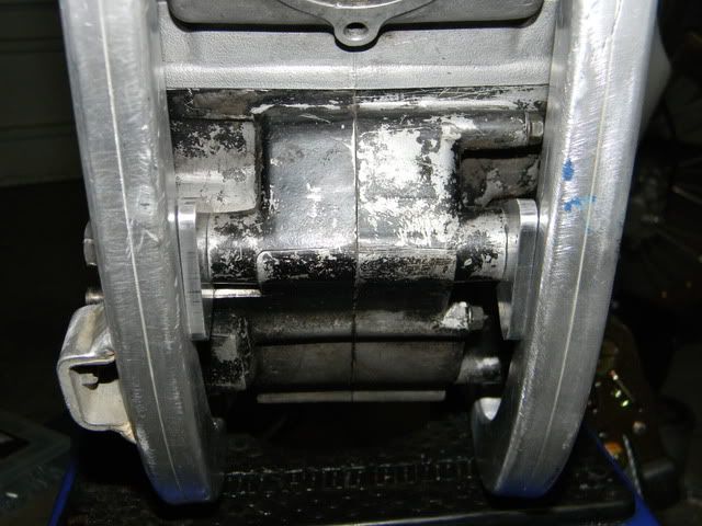

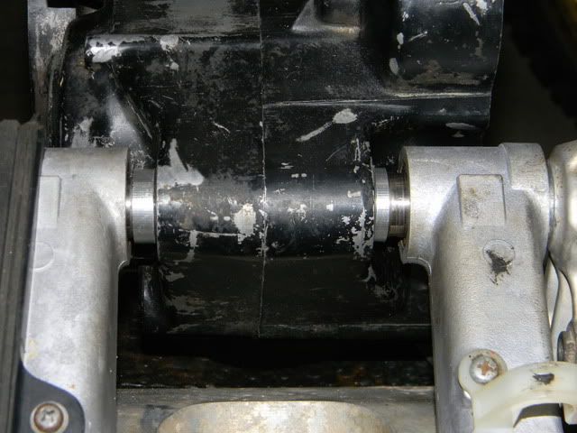

Is this really a gap, or just a photo shadow??
If it is a gap, DO NOT TIGHTEN THE BOLT TO CLOSE IT!! Get a thin "AN" type washer to stick in there.
If there is a washer on one side, and not the other... so be it.
Pinching the frame to close the gap raises the natural frequency of it, like tightening a guitar string.
The higher the frequency, the more the bike will buzz.
Everyone says my bike has very low vibes.. even lower than a steelie. Its not the engine... its the install. I shoved washers in every gap before I tightened anything down.
Its very "dead" as far as vibes go, and I attribute it to this assembly method and double headstays.
No it's not a shadow there is a slight gap. I might be able to get two thin washers on each side. Bob I do remember you saying not to tighten it up, I think you said they were also called half washers and could find them at any "true" hardwear store.AlisoBob wrote:Is this really a gap, or just a photo shadow??
