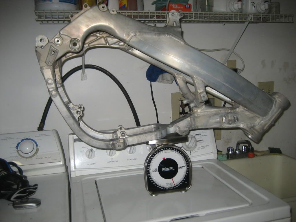

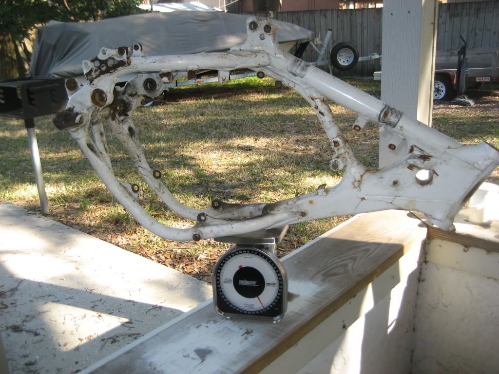

Post by yota »
gen 3 125 frame after mods 22.5 lbs
94 CR500 steel frame (with footpegs) just under 21 lbs
just thought that was interesting.

yota wrote:gen 3 125 frame after mods 22.5 lbs
Does this mean you have disassembled your AF coversion for some reason?
no I weighed the alum frame way back when and just got around to weighing the steel frame a few days ago.
so the weight of the ali frame would be even closer in standard form without the billet y piece

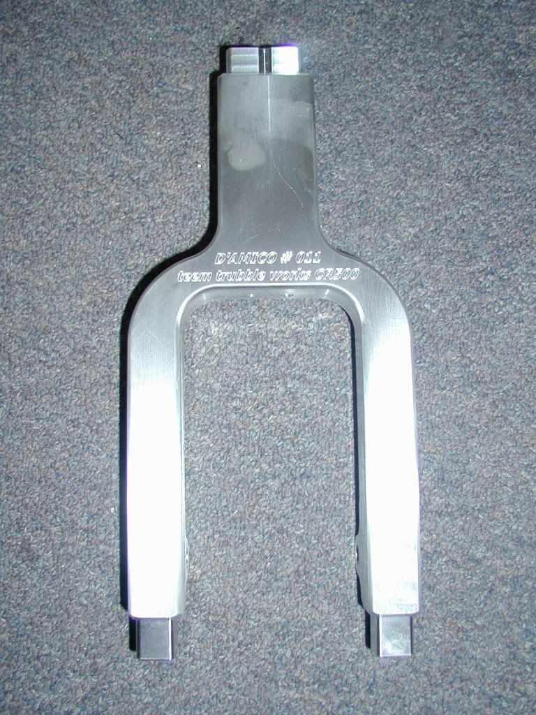

the billet Y pc is hollow but surely still weighs a little more than the stock pc.

yota wrote:the billet Y pc is hollow .
Not any that I have seen are.
Those things are heavy.

I would love to see one before it is welded in.. Seems like alot of work to hollow out a peice of billit like that.. None the less those frames sure were nice.. too bad everything went the way it did with that guy
Bob I'll bow to your experience but when I got the frame I did some tapping on the Y pc and it sure sounded hollow. I also remember a thread where AJ kind of accused Mike of copying his Y pc and Mikes asked AJ if his were hollow? Maybe I'm wrong, Ill go home and bang on it again.

At the very top, where it index's into the OEM down tube... its machined to fit inside the downtube and that pocket is milled out a bit, but the rest is solid aluminum.

good info yota. i do recall the xr650r came out with the alloy frame that was 3kg heavier than its steel predecessor.
and bob, i think some y sections are hollow. ive seen the honda ones reused once the welds are grinded away.but yes, all the billet ones i think are solid.
