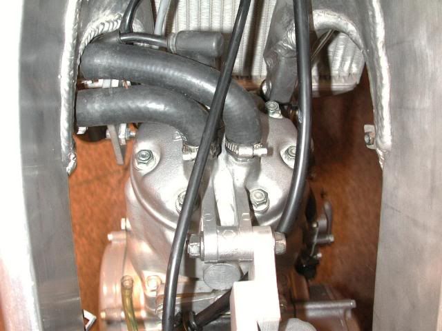

OK guys, the machine shop really laged, but we finally have kits in hand.
We're offering a discount on multiples.
$150 per kit
$250 for 2 kits
each kit consists of 2 front mounts (with 7* angle) a headstay, SS swingarm bolt spacers and the coil bracket. here are some shots of my kit which was the very first one made, I don't have any pics of the final production (which looks even better) because my cousin has them. Everying is %100 CNC machined!!! every peice is identical!!
we are ready to ship kits!

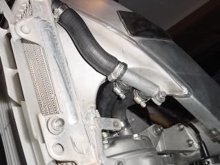

You also need these hoses and this 2 into 1 hose adapter........
yeah, the only other stuff needed is plumbing stuff for your coolant lines (I used hoses from the 2 donor bikes and a $3 splitter from lowes) and the exhaust mounting (I made it work without buying anything)
my Gen-1 build post shows it all
http://www.bannedcr500riders.com/board/ ... .php?t=189
I made a couple modifications to the kit so you won't need the washers.
The build is surprisingly easy and ever a pro fab shop shouldn't charge more than $40 for the welding.
any '97-'99 cr250 chassis will work.
