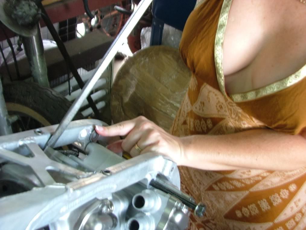

shiming the engine, i placed 1mm washers between all my engine to frame mounting points
tightining the fromt mount bolt, i couldnt get a zink bolt all i could get was a high tensile black..it will rust very quickly. (BUGGER)
OUCHY OUCHY OUCHY the bolt i was holding spun in my hand.

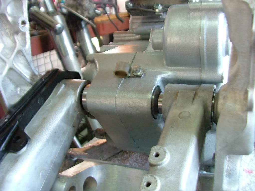

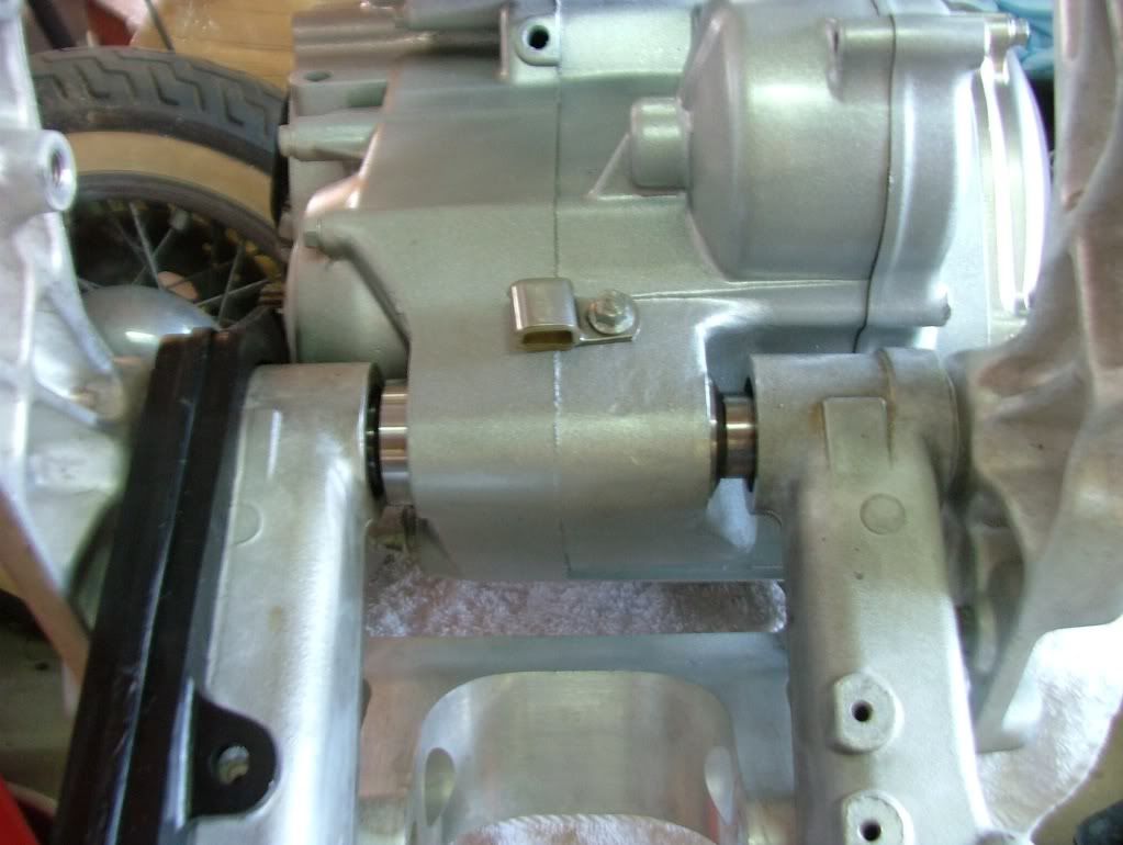

the swing arm now in place, i'm very happy with my OEM look spacers.

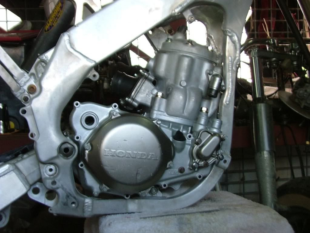

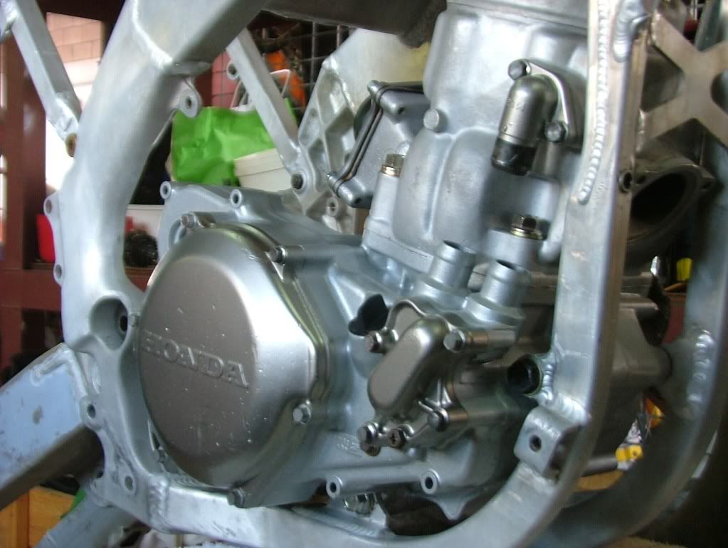

The motor in place for the last time (pending service intervals)
that motor has been in and out of that frame over 15 times..the wife & kid never let me forget this fact.

asteroid500 wrote:the swing arm now in place, i'm very happy with my OEM look spacers.
The OEM looking spacers / engines bushes are they made of stainless steel?
Also what is the bracket bolted to the rear of the crankcase for?
I would guess that bracket is there to hold the engine breather hose?

R7...yes they are....alloy and stainless??????well you never need to take them out so i went wih the stainless.
Baze...yep,and carb, in the pony express races i do, 3hr enduro's were sent through alot of swamp and the Gammba grass wraps itself around every thing and pulls it off as you ride

Question on your spacers are they load bearing or do they just take up space.

the swing arm spacers serve no purpose but to "take up space" and eliminate any side to side movement of the swingarm. The spacer material choice between stainless and aluminum is, well......immaterial.

Agent...i placed the spacers with the required spacing in my engine because i was sick to death trying to get those 7mm-4mm spacers between the engine and the swingarm while trying to hold the wheel & all the other shit in place.
Now it just slides in like it was meant to be...OEM style
theres no load rating, metal fatige levels, expansion increases, weight gains or loses, just my way of solving a problem, and it works fine.
