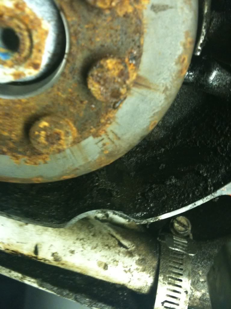

I pulled the stator cover and found a mess of spooge arourd the flywheel Image
lovely. nothin beats a good ol rusted out flywheel :D

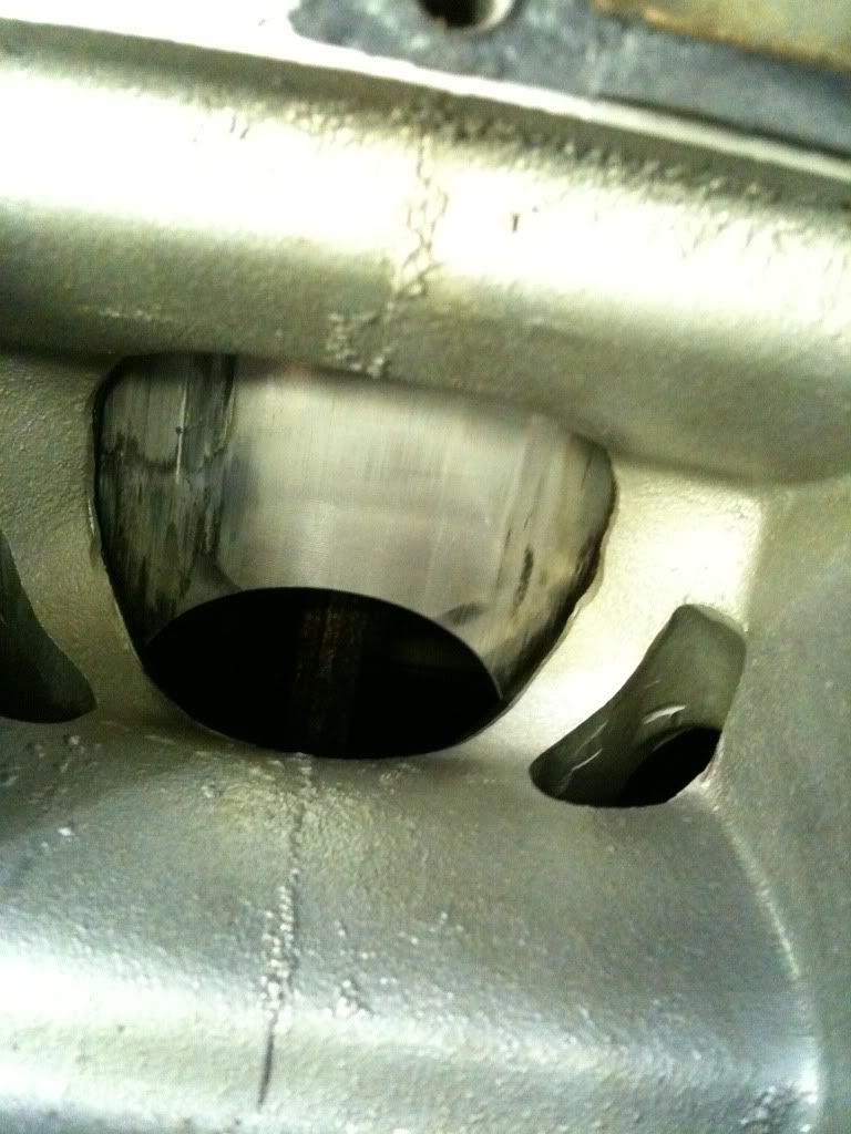

I also pulled the reed cage to take a look at the piston, and sure as sh!t it's cracked :x Image
i dont see a crack but i see some scuffing and gouges. usually the crack starts at the high point of the arch.

Sorry crap pic. There are two cracks at about 10 and 2 o'clock on the cutout, coming up at about 45* angle

they could be cracks, double check to be sure. you will get some marks/discoloring there becuase thats BDC. this is what ive typically seen, the crack is at the high point, you can see some 10' o clock and 2 o clock marks that appear to be cracks but they are actually just marks because thats where the piston hits bottom. yours may be cracks but honestly ive never seen them start in that location.

Good call 100hp. Still gonna replace it :) as y'all ca see it's not to fresh :D I probably jumped the gun calling it cracked. On the bright side this is a perfect excuse to tear it down and get it ported :devious: :devious: :devious:

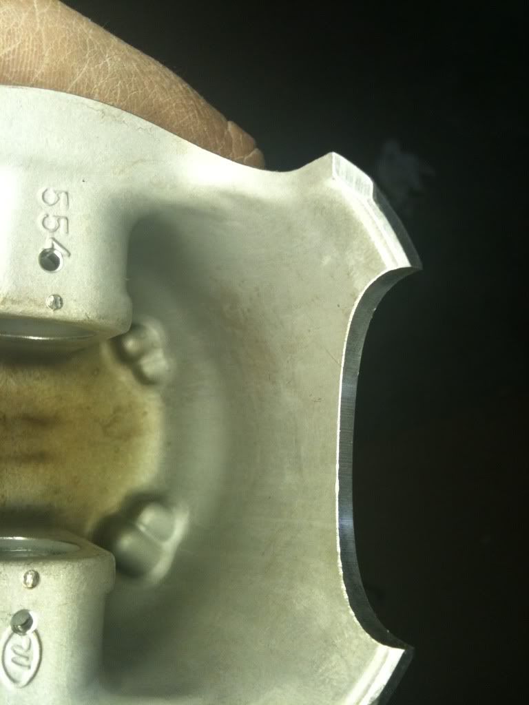

So much for the 250 ign. This bike is a basket case! The swingarm bolt is stuck, so I'll need to cut it out and redo the bearings. The wiesco piston IS cracked.Image
