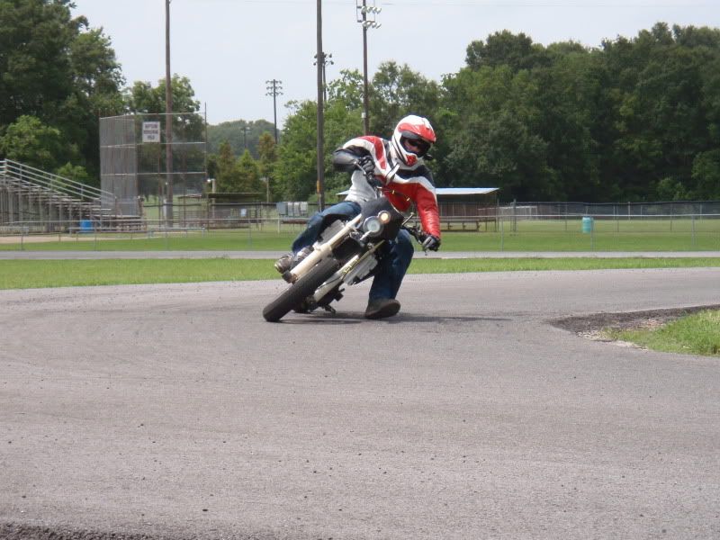

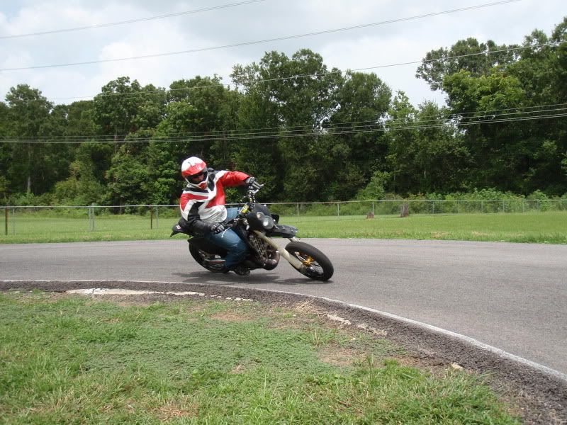

as some of you may know, i finished building my CR500AF in late May after a couple months from tear down to plated and riding. it is the most fun bike i've ever owned, but i don't really ride it too much. to get to our version of the fun stuff, i have to ride 45 minutes to an hour away, so my XRR is what i end up taking most every time. not that the 500 won't easily do it, i am just fairly easy on my bikes, and i know i can cruise at 80 the whole way there on the XRR to make the trip seem shorter. i mostly ride the 500 to work and back since i can play around in town on my way, and to bike nights so i can shut shop around the sport bikes and choppers. i took it to a Kart track about a hour from here, and it was a freakin blast.
here are the specs:
2005 CR250 with a 94 CR500 engine squeezed in there. a friend and myself did all the fab work, and another friend's dad's metal fab shop did the aluminum welding and laser cut a few brackets. i did a TON of research to make sure everything was done as nice as possible. even the wiring is heat shrinked to look factory. in the build thread we look like we just started cutting and whatnot, but i assure you this is a extremely well built bike. i can change a full length plug with the tank still on, but i run the BR8ECMIX iridium short plugs. i haven't had a need to change a plug yet though.
