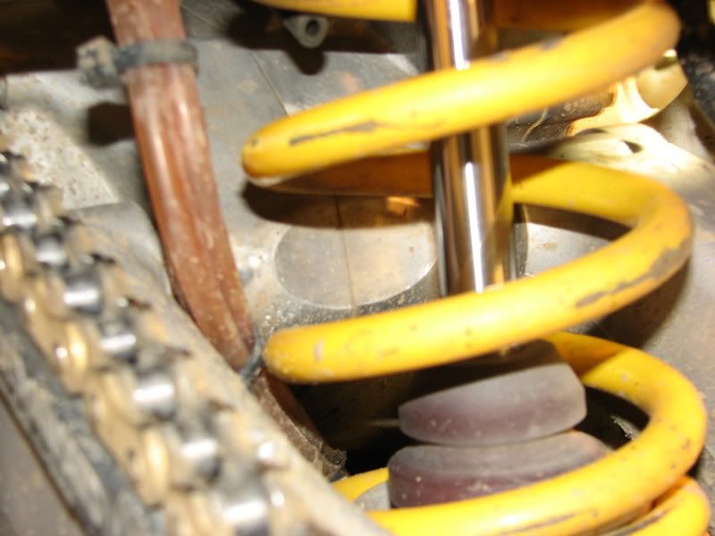

My 02 & 03 shock spring rubbed the cases so I clearanced them :wink:
My 02 with 01 motor. Now mind you this is a SH that SH/AJ shipped out
to a customer with it rubbing the motor :roll: you can see the paint rubbed off the spring in the pic.
My 03 with 86 motor
i dont get this. if your using stock spring on gen3 cr250 why does some rub and some dont ? :?:
They are all a little different... :wink:
