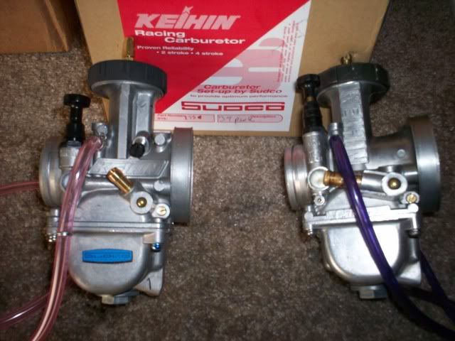

eyesky2002
Posts: 492
Location: SW Iowa
Post by eyesky2002 »
slomas wrote:You probably have a PJ carb- the choke and idle circuit are the same... and they suck...
Left is a new 39mm PWK and the right a original 38mm PJ, note the idle screw right above the fuel inlet on the PWK, mixture screws are lower and right of the inlet...
I had nothing but issues with old PJ, the new PWK was the best $200.00 I spent :D

sikryd
Posts: 13
Joined: August 14th, 2008, 2:24 am
Post by sikryd »
OK... mine is a pwk, looks like the one to the left in your pic. I thought the black plastic screw with the spring above the fuel inlet is the air screw. no? It seems at idle, turning that screw either direction does not seem to do a whole lot. I start at 1 1/5 turns out from bottomed, and have gone almost all the way out with no effect on the idle. Maybe I should just buy 2 new ones. Damn..... I hate spending money, probably the chinese in me.
