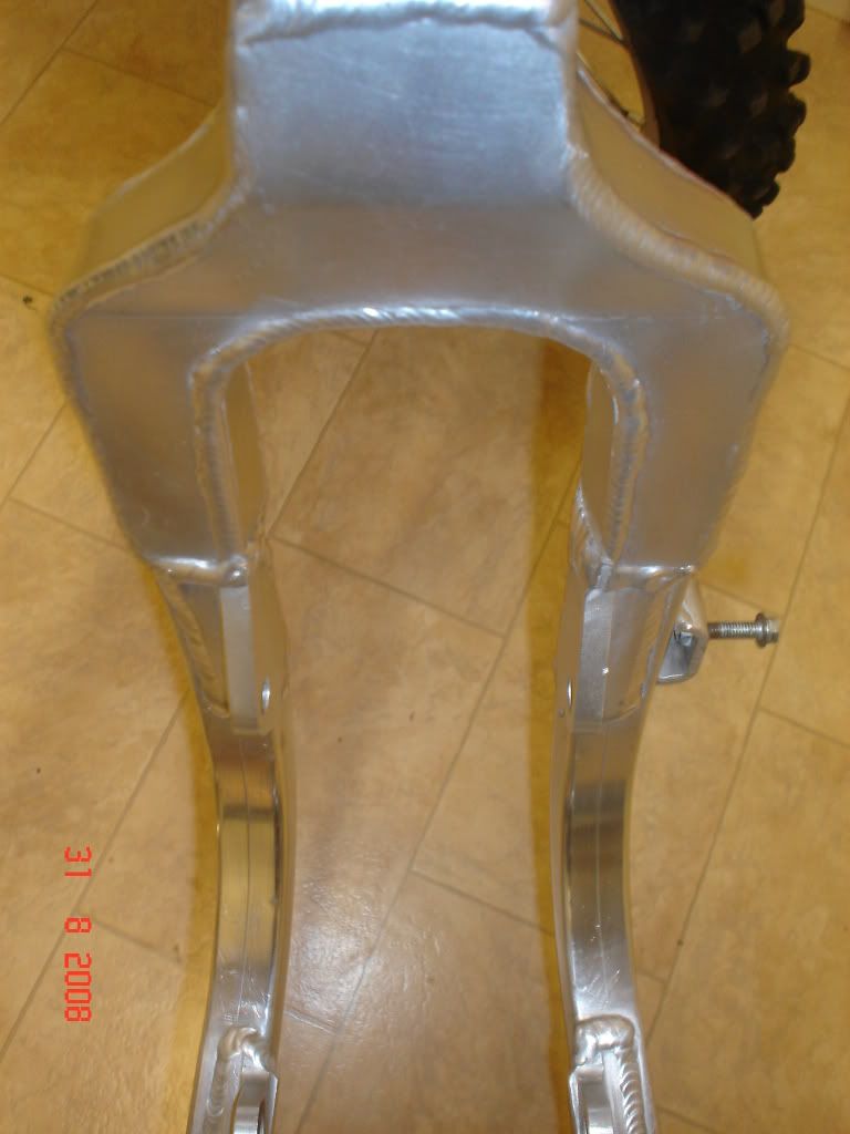

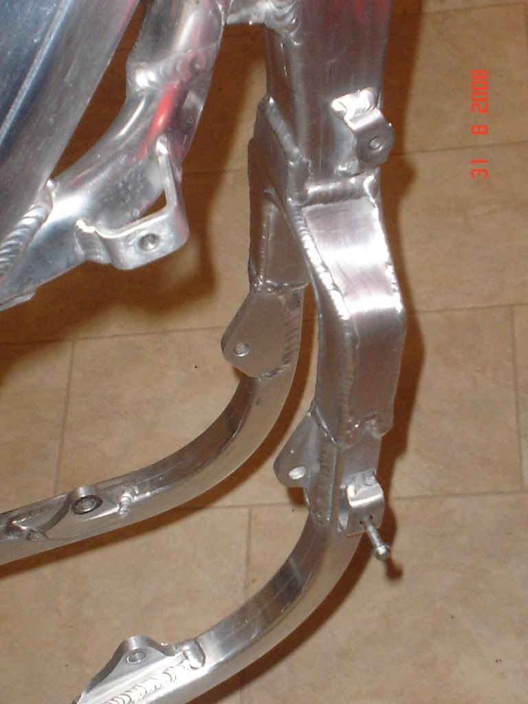

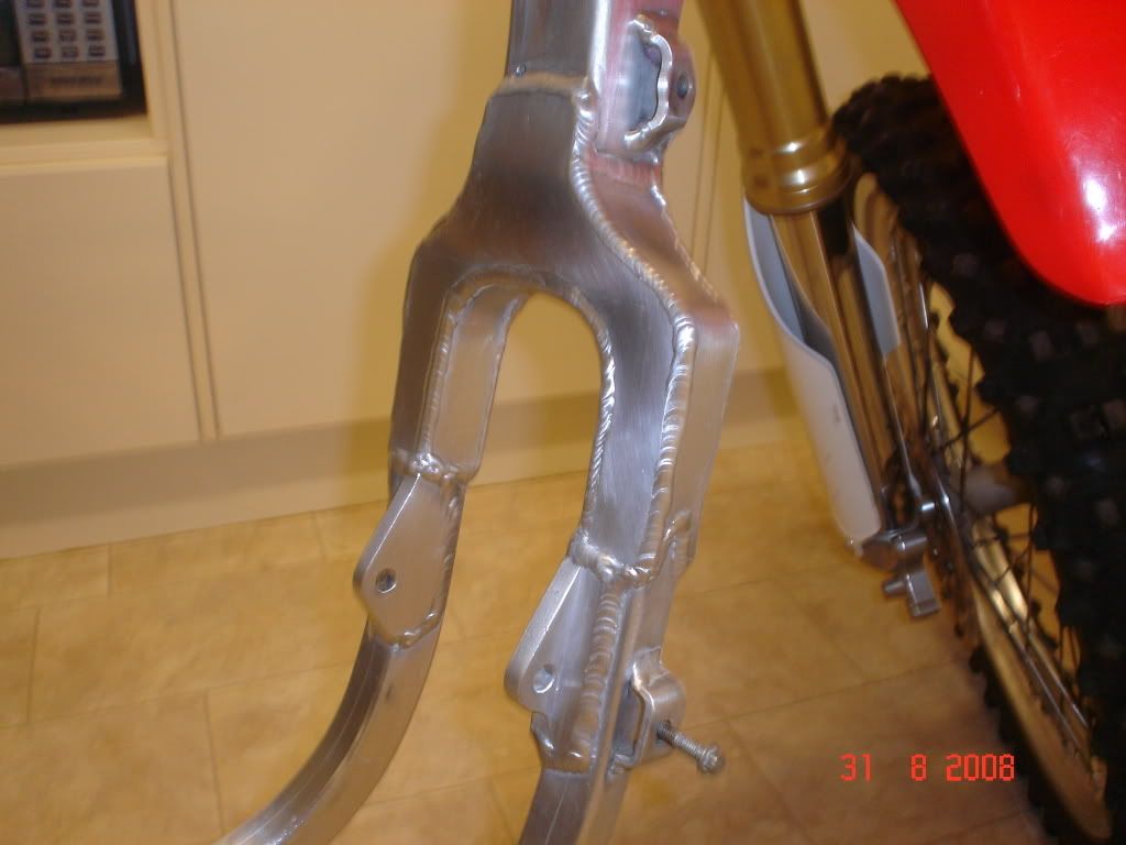

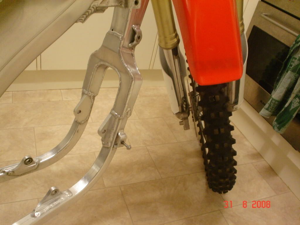

some pics of the frame mods . (if ive posted them correctly!)

Im pretty happy with the fabricated y section, i have heaps of pipe clearance, but it was alot of work and next time i think i will reuse the origional y and bend up some new cradle tubes.

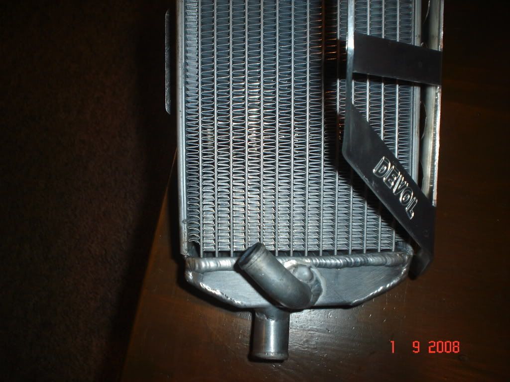

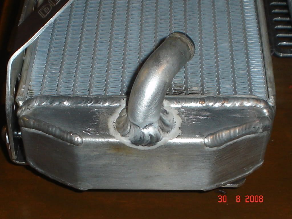

I fabricated new lower tanks for the rads so i could move the y up a little more for pipe clearance and move the outlets as required.
And, i would have built the whole thing in the kitchen if i could talk the wife around :D
davo77 wrote: I fabricated new lower tanks for the rads so i could move the y up a little more for pipe clearance and move the outlets as required.

Those rads were a pain in the ass to weld. I had to run the tig torch over the joints a couple of times to burn out all the impuritys before adding any filler material.. Was worth the effort though to get the y up a little higher
cheers
