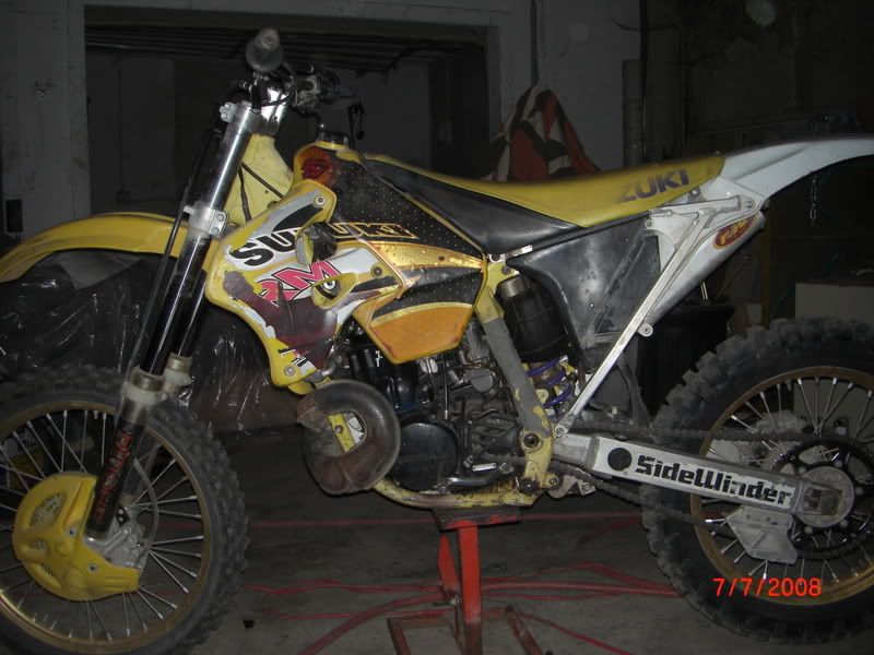

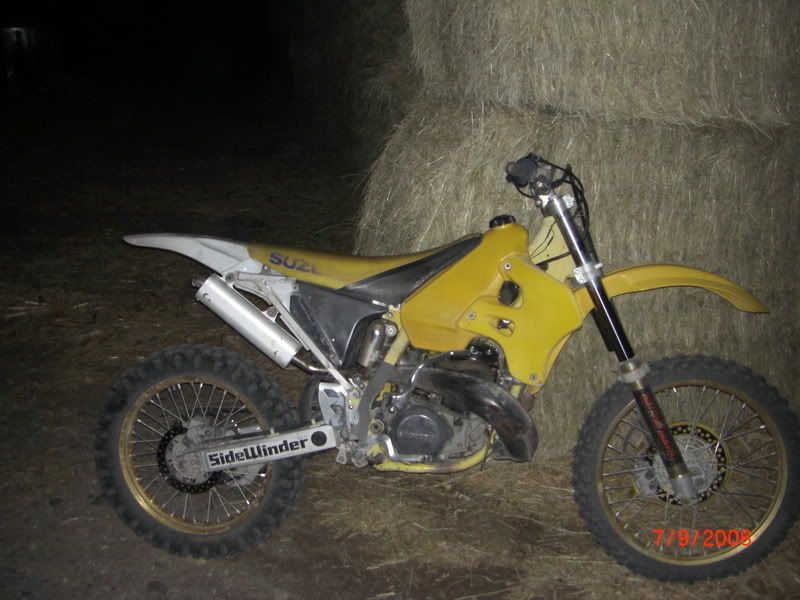

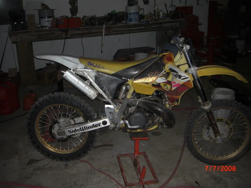

My version of a conversion. First test run ran tonight in twilight seemed to work good. I have a few details to clean up. Ported '87 motor hauls the mail.
What year is that Zuchini? It doesn't look to be a aluminum frame or a twin spar frame for that matter. I know the new ones are, only Yamaha still makes their bikes the old fashioned way, wonder why? Anyway glad to see your conversion is working, even if I don't think it looks very good.

No problem Mick, any time your in colorado your welcome to. I like that chassis too. Its actually a pretty low hour bike it just sat out side too much. Nothing a little grease didn't cure. The only think I had to buy to get it done was a copper tee and a rear sprocket. I'm going to need some aluminum sheet to finish up the air box. Pretty low buck. It wasn't too hard to get the motor in there. Had to move the bottom motor mounts shim the swing arm very little re-drill the front motor mounts hack just a little bit of the y out weld a tab for the coil lengthen the ignition wires. Pipe mounts actually lined up with a steely mount in the front. I'm not quite happy with my cable/wire routing yet but I'll get that figured out. Took it out for a little spin this morning, man it sure sets into a corner nice.

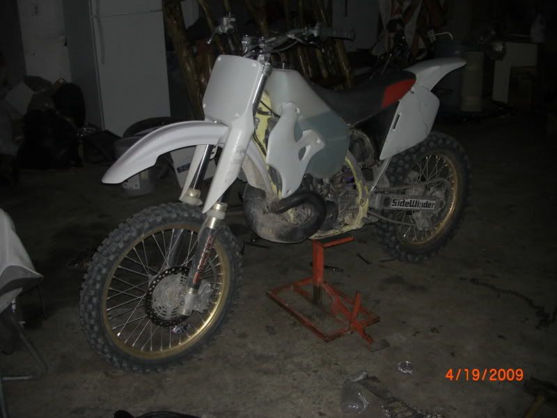

Did a real shake down run on it tonight performed flawlessly. I need to adjust the rear brake maybe even put little air in it, its awfully touchy, and I need to do some suspension work. I felt like a wookie on a minnie bike. Part of its getting acclimated part of it is bad setup. I'm pretty particular about setup looks is a whole other subject. Next project gen2 CR500AF. Just got a fresh motor from haulinarse. Looks to be close to immaculate.
So kudos to haulinarse for being a stand up hoon. One thing I'm really surprised with the RM is the lack of vibration. It has solid mounted handle bars and vibs are less than a steely through the bars and at the pegs. I'm very happy with that. I'm stoked on the motor too. It is very ridable and has major cajones. Tried a roughed up hill climb and the first run I almost looped out and had to let off. Letting off the throttle equals not making it. Second run I was ready and made it with not problem. Here is a pic for the bling kings fresh wash no graphics. Next time you see it, it will not be yellow.
