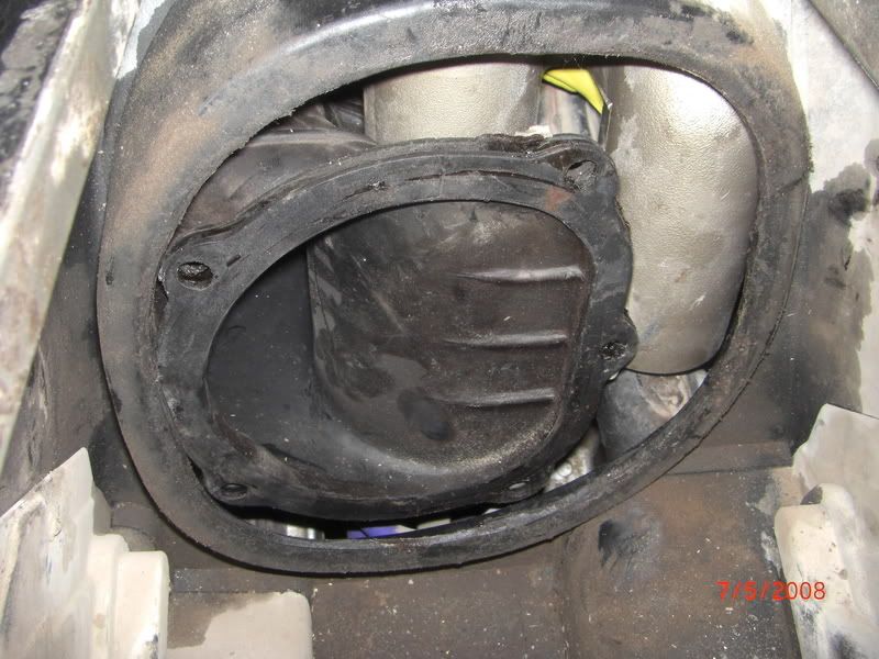

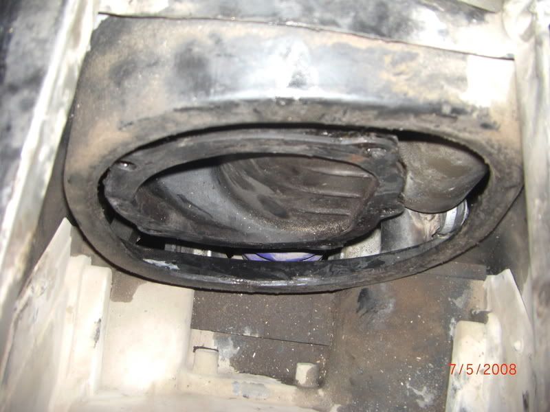

I'm having serious difficulty getting a satisfactory air box into my project. CR500 into 97 RM250 chassis. The stock airbox is complete dog shit. The air boot does not even bolt in. It slip fits!! The stock air boot is so far off I'm not even tempted. So the best solution that I have came up with is to cut the honda airbox in half and connect it with the suzuki box. My problem is how the suzuki air box is shaped. It is not flat on the front. Makes attaching anything air tight kind of challenging. Any ideas??

I say you make a little plate that the airboot will fit into with the filter on the otherend, then bund the plate around that air box and rivet it into place. kinda like what bob did for his gen-4 box, but with some heat to mold it.
Couldn't you do something like the pic below and then use a pre-2002 steel airbox base (the piece the filter sits on), etc?
If my memory serves me correctly, that was 3mm aluminum stock.
