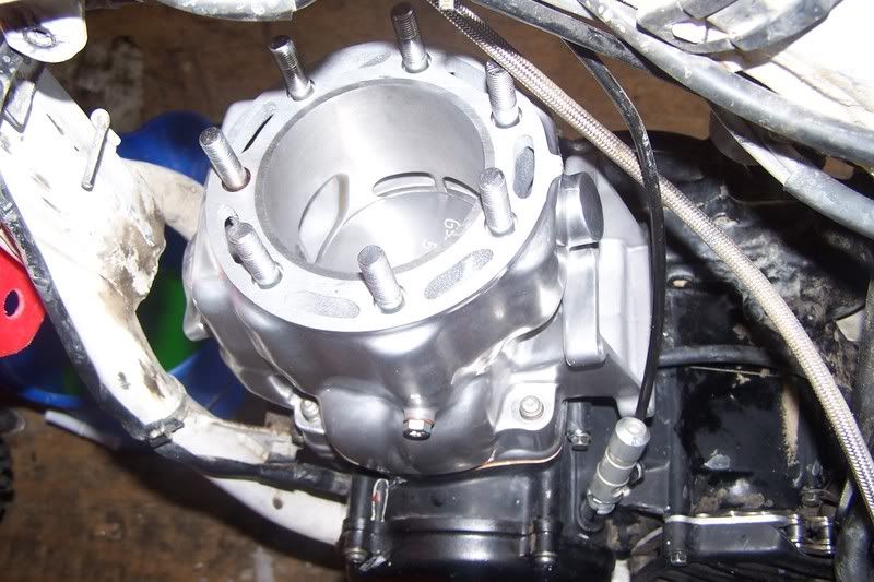

Did some wrenchin today and got her pretty much done apart from the pipe and intake.
Glen did a bitchin job on the top end for me :D
Studs installed, I chased the the barrel threads with a tap then cleaned 'em out with carb cleaner and compressed air, then wound the studs in as hard as I could pull. I put a stock '89 top end next to it for comparison.
Bling piston :lol:

Do have the measuements on those exhaust ports? They look stock to me aside from the skinny bridge. I'm curios how many mm's they are cut on top.
They are completly different to stcok in shape and size, they are also higher. I dont have any measurements.
Have a look at the decompression scalops for comparison. Looks like 1 or 2mm higher.
brit take that exhaust up another 3mm before you put it back together :cool: . and grind on the transfers alittle while your in there :lol:
100hp honda wrote:brit take that exhaust up another 3mm before you put it back together :cool: . and grind on the transfers alittle while your in there :lol:
Look at the last pic, its already together :wink:

see the studs were in already,all I rec to work on was a cyl and I bored it with a torque plate and honed it and replaced a piston only no head. I keep records job was doneon 5-4-2008 . up dated Glen 12-24-2009
