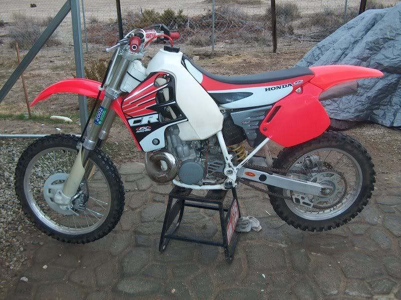

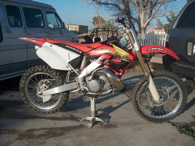

It's about time, I pulled both engines and started mock up. Ill have pics soon this is what im starting with, as soon as i figure out why my pc wont recognize my camera ill post my progress.Imagecr500 1997
Imagecr250 2001

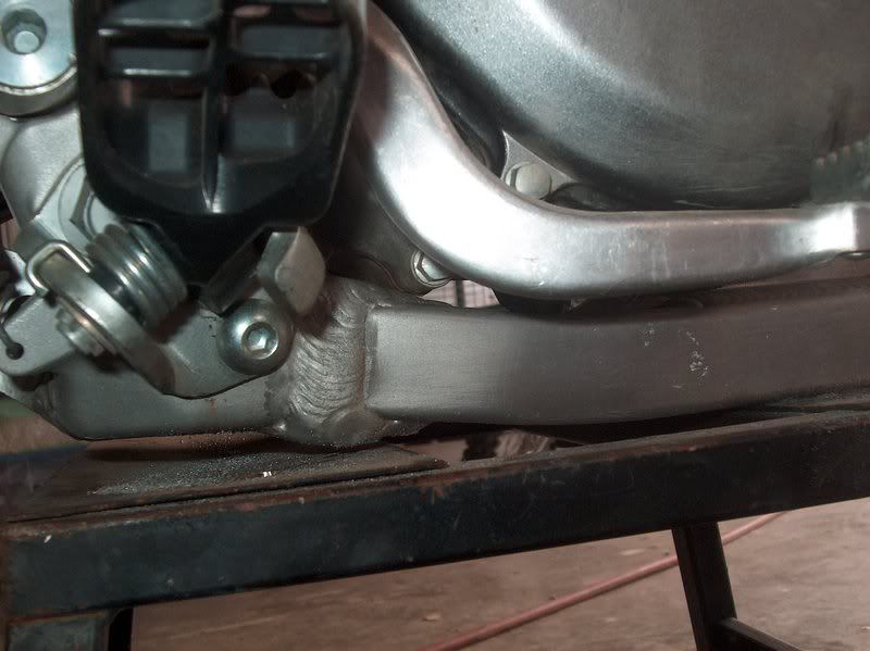

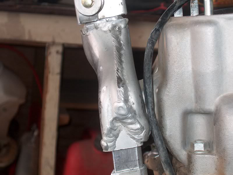

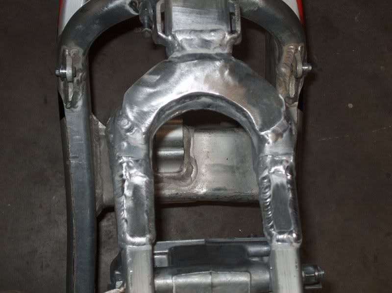

this weekend has been so fun i started tearing apart both bikes and started to mock up gen2 frame. removed front mounts and cut out Y. cut out fron mount area for 7/8 dowel for front mount. thoese are done and just need to be welded. engine alighnment doog with spacers and will pick up some round stock for coil mount just above cyl head just to the front. Im modifying Y to accomadate stock placement for radiators. I moved up the Y about 1" and installed solid rectangle stock for the down tubes to slide up into Y. Ill keep you posted. Image Image Image Image Image Image Image

That looks scarey :shock:

somebodys got some clean up to do :o
nice! a little mad max-ish on the welds... Clean 'em up and RIDE! :wink:

I know they arent the best looking welds but i was there to see the first welds layed down and they looked real good than the welder filled in the low spots thats where i need to do some clean up. :lol: :shock: :( :oops:

:yikes: I concur :lol: Thats why I'm reluctant to build one here in Gjoa Haven,thats the kind of welders I have to work with,but hey as long as theres good penetration :mrgreen: , :drool: mmmmmmmmm Penetration,Just take the time to clean it up nice.
