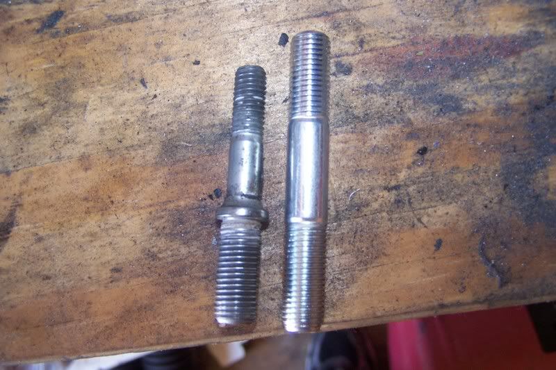

Bigger is better baybee :)

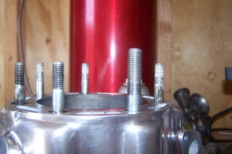

I had to cut extra threads as the nuts would have bottomed out, now all Ive gotta do is the other 6 and drill out head and gasket. Should be good for 45ftlbs and no more blown gaskets :cool:
Im probably gonna shoten them a bit also to save my hands when plug swapping.

I see two probelms.
1). The bigger stud means less surface area for gasket seal.
2). Bigger holes in the head also increase post torque distortion. Make sure you have it torque plate honed again!!
Did you try torquing the exsisting studs at a higher rate?? I bet you could get some chromolly studs from ARP that are the same size as stock and saved much time and money!!
have you broken head studs ? why ?
I know some one with an O ring head
M.F.D.B. wrote:I see two probelms.
If you look at the barrel it already has a 10mm hole with a gap around the edges, theres no sealing going on there so as far as surface area it will be the same as stock.
Glen is doing the bore so it will be tq plated.
What do you think the chances are of ARP having short headstuds that are 8mm on one end and 10mm on the other????
So you didnt have to drill the hole any bigger??
britincali wrote: Glen is doing the bore so it will be tq plated.
Does he have a plate with holes that size??
britincali wrote: What do you think the chances are of ARP having short headstuds that are 8mm on one end and 10mm on the other????
Prolly pretty good, did you check?? Theres TONS of companies out there... :wink:

If you look at the stock headstud its 10mm on the barrel side and 8mm on the head side, the base studs thread straight into the barrel no issues.
I dint want to go into specialy made copper gaskets and overall i think this is the easier cheaper way to go, I dont think its gonna blow anymore gaskets when TQed to 45ftlbs.
Im gonna call glen but seeing as it was his idea to go with the bigger studs im pretty sure he has a plate to accomodate.
This wasnt by any means my idea glen at GSS said hes done it to a few of the hillclimb motors, I was gonna have him do it when I dropped the barrel off but I was bored this morning and figured Id give it a shot :cool:
