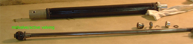

Now that you have the base valve out you can pull on the damper rod and the cartridge will come out.

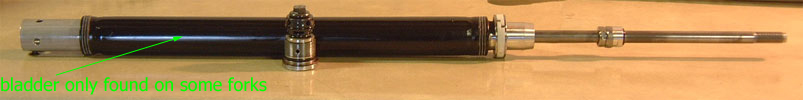

This is the cartridge and base valve. Note on this bike the cartridge is covered with a black rubber ‘bladder’, which is supposed to provide better bottoming control simpler to the way ‘sub-tanks’ work.

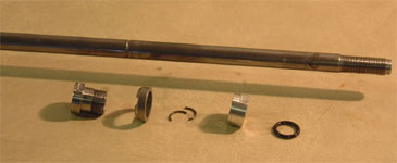

Here I am removing the bottoming cone that also stops the damper rod going too far into the cartridge. On these forks it is simply a matter of screwing the two parts apart using a 19mm spanner and a ground down 19mm spanner. Other forks use different mechanisms though… On the YZs for instance you have to take the top of the cartridge which can be quite a job and not for the beginnner. If you do not have a simple bottoming cone like the one in this CR just don't bother taking the damper rod out of the cartridge, it's not worth the hassle!
This is what the bottoming cone looks like in pieces.
Now that you have the bottoming cone off, the damper rod can just be pushed out the bottom of the cartridge so you are left with things as shown in the above pic. On the end of the damper rod you can see the rebound piston, shim stacks and maybe check valve which together primarily provide your active or rebound damping. You should use compressed air to blow all the old oil and debris out of the piston and around the shims etc. Same goes from the base valve.

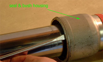

Now we want to separate the inner and outer fork sliders. At the moment they are being held together by the fork seal and the two bushes. Heat the seal housing gently as shown, this will make it easier to free the bush and seal and limit bush damage. Do NOT over heat it, 15-20 seconds of heating should suffice.
* Since I first wrote this article I’ve been told that a better way of heating the seal housing is to slowly pour half a kettle of hot water over the housing. This will stop the flame discolouring and marring the look of your forks and will also prevent you overheating the seal housing which would melt rubber parts in the housing.

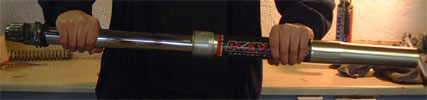

Now grip the fork as I am in the picture and using fast but NOT forceful movements repeatedly pull the two sliders apart. You will see the seal coming out a little bit each time. Sometimes they will separate first time, sometimes it can take a LOT of pulls so just keep going.

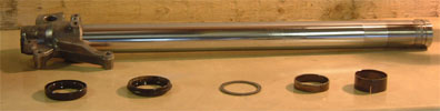

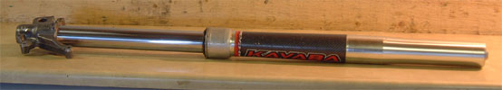

So when you get the fork sliders apart you will have the bottom one like this.
Remove the bushes and seals etc from the fork slider.
This is one of the bushes, you will see it is covered in what looks like black plastic or Teflon on either the outside or inside. If this is considerably worn at any point you need to replace that bush, and probably the other one as well.

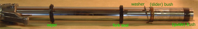

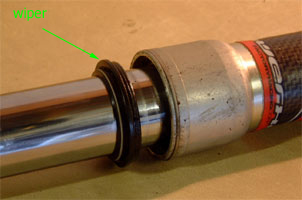

Now back to the fork seals. You should have cleaned up the lower fork leg at this stage, removed old oil and dirt etc. We now need to get the wiper and new seal back onto the fork slider, WITHOUT damaging the lips of the new seal. The best way to do this is wrap a piece of plastic bag over the top of the fork (covering the sharp bush holder etc.), then coat this bag in a liberal amount of fork oil. Cover the wiper, new fork seal and bushes in clean fork oil as well. Now just slide the wiper and new seal over this bag onto the fork as shown above. Obviously you want to put the wiper on first, then the seal. Then remove the bag and put back on the washer, not the washer has a smooth round side and a sharper side, the smooth roundish side should face the seal. Then put on the two bushes.

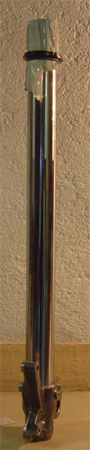

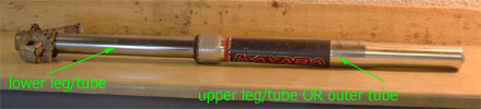

So now your lower fork slider should look like this. Now just place this lower slider back inside the upper slider. The first bush on the end of the lower slider will slide into the upper slider easily. Next comes the second bush though, this needs to be driven back into the upper fork slider.
