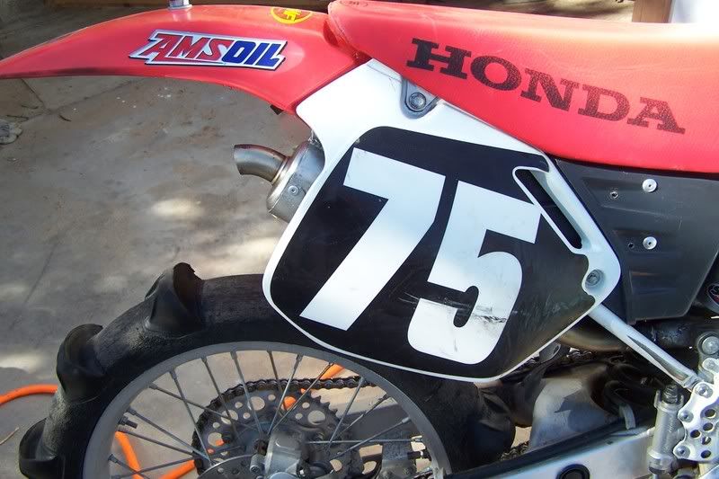

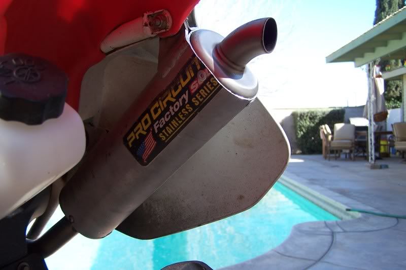

A few weeks ago I got bored and decided to chop down the silencer on the GSS bike. I got roughly 2.5-3" off the end and re-riveted it back together, it definatly sounds better and should help over-rev a little :cool:

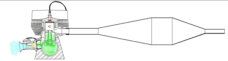

Did some searching and came across this on wiki...
The length of the pipe determines at what time the waves arrive back at the cylinder. Longer pipes require more time for the waves to traverse and so will be tuned to a lower rpm than a shorter pipe. The shorter the pipe the higher the rpm it is tuned to.

britincali wrote:Did some searching and came across this on wiki...
Go research the stinger. That is one of the reasons a newer CR 500 revs out further than a older model because Honda specially made that super long silencer to do that, besides quiet that was the main reason. Longer stinger means more topend. They are talking about the back of the pipe and how it deflects the wave back not the stinger it is seperate

The end of the stinger produces a wave form that combines with the the waves returned by the different parts of the diffuser. The timing and strength of that wave is a function of the stinger diameter and its length. I have a Pro-Form "torque" pipe on my Elsinore and the pipe is longer than stock, and then the silencer is longer still. More mid-range, less top.

I just got of the phone with glen from GSS he told me the main job of the silencer is just that, to quieten things down.
As far as length it does pretty much squat, the stinger section of the expansion chamber is the biggest contributing factor.
