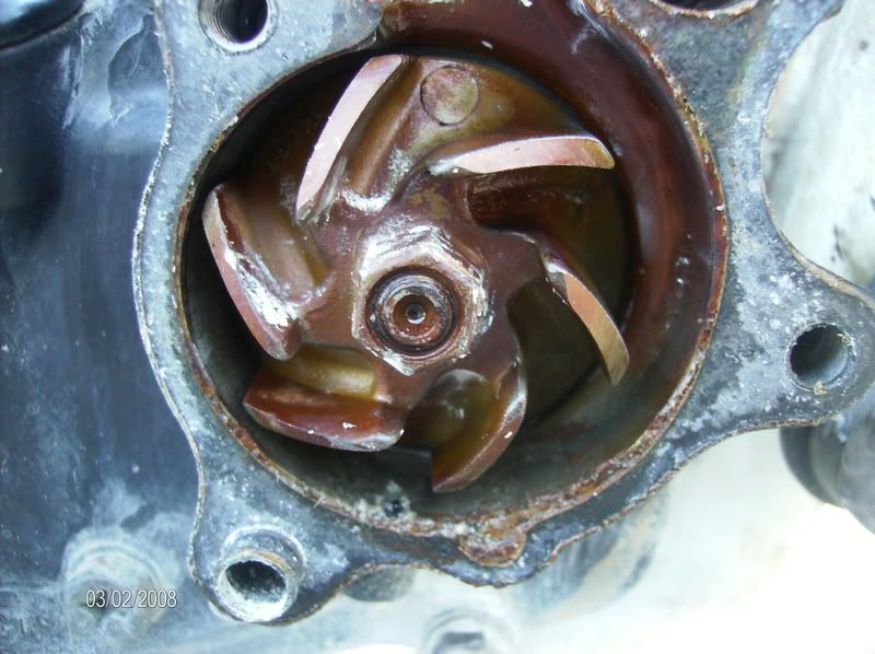

I have a pair of 89 rads Ill part with, make sure your water pump is in decent shape and not too corroded.

I just talked to Jay.... He pulled the head off, but the rads are still full of green coolant...
:shock:
I had him pull the pump drain bolt.... dark nasty stuff came out of the block and jug, rads still full of green coolant.

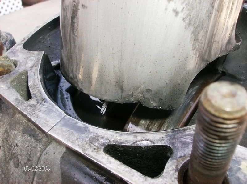

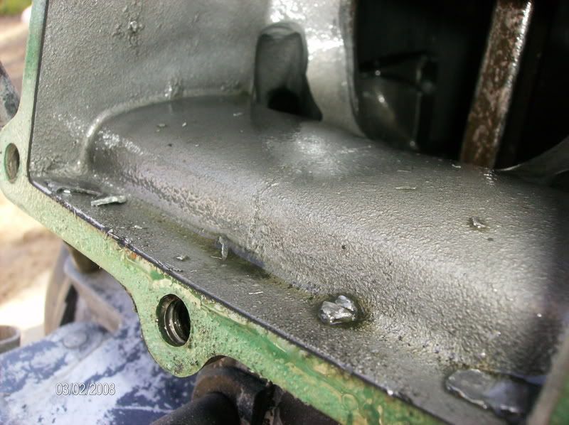

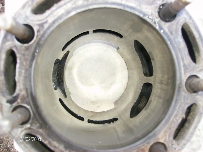

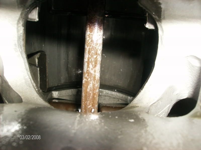

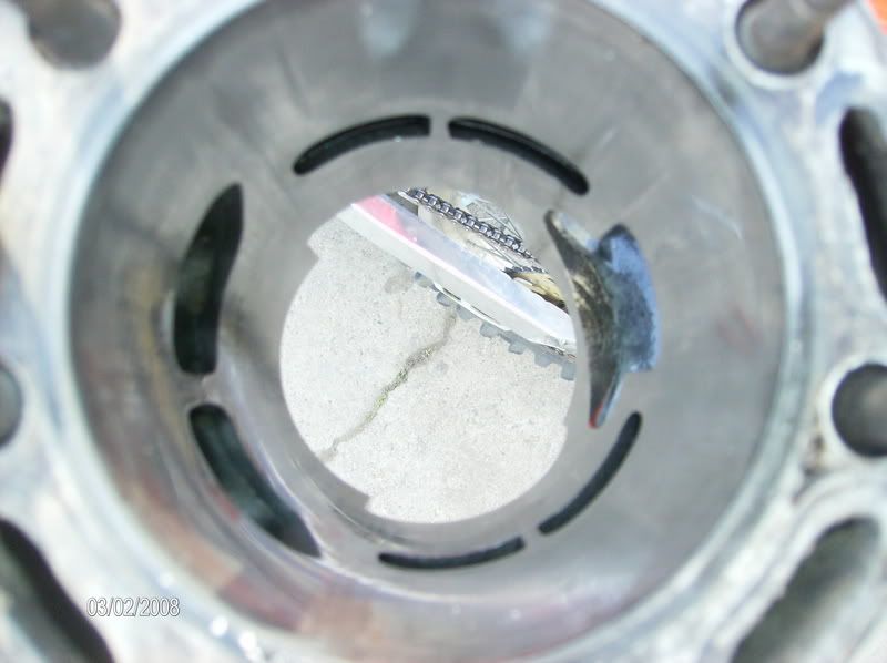

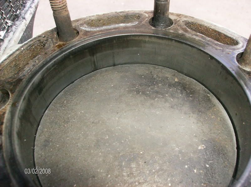

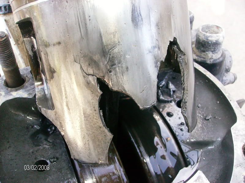

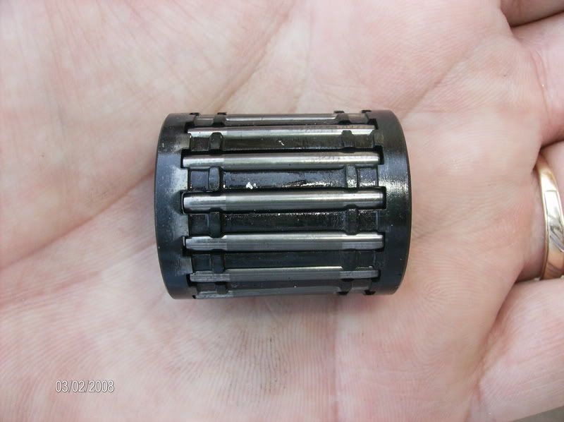

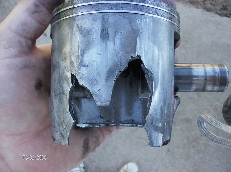

ok, first find after dropping he radiators is that the right side unit a ( with the cap) was absolutly 100% clogged.. you cant blow through it or pass water through it at all.. not even a drop. so overheating was my downfall and my fault for assuming i cleared the rad problem up last time when i clr'd them. the piston skirt scattered on the intake side, i think ive managed to recover about 80% of the pieces so far. the piston has a w with a circle around it on one side of the wrist pin journal and a 55 on the other side... does this mean wiseco .055" over? how far over can you go? heres a few pics of the aftermath, one with the piston in the place it froze in the jug, a couple of the reeds and reed cage where i first found chunks of piston, the "custom team bigjay racing piston" itself and a couple of the jug etc.

Looks like a stock piston to me, as I can't see any writing on the crown and its shattered :lol: :lol: :lol: :lol:
Is your rod bent or is the camera playing tricks?
You got some major re-building ahead of you son, start splitting the cases....

i think its the camera angle.. the rod look straight to me, but i see that in the pic it looks bent.. having to do the bottom end is about the only thing that could suck worse :)

No way..that's a Wiesco..... 100% .

AlisoBob wrote:No way..that's a Wiesco..... 100% .
Well then we finally have a pic of a cracked wiseco!!!!!! :lol: :lol: :lol:
