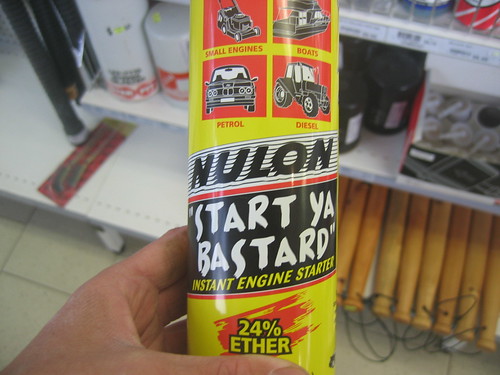

Try some of Brits favorite " Huff- Juice".....
