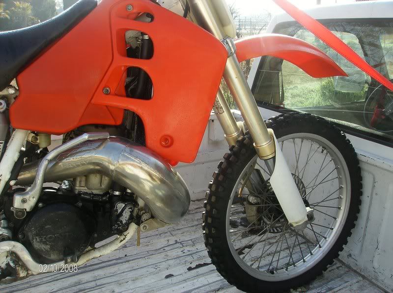

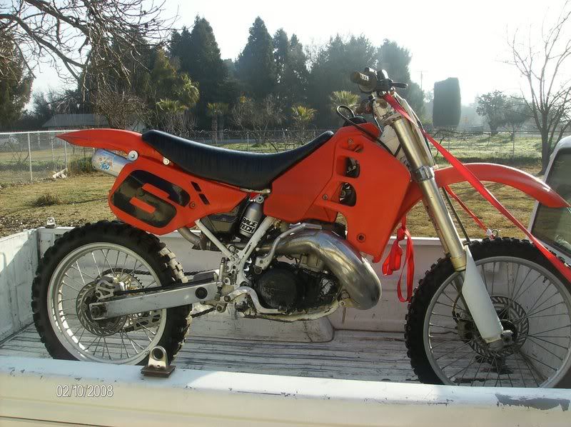

well, i looked at 3 bikes yesterday.. what a long day. i ran into a nice 86 but the guy couldnt produce a title and right at the end it seemed really shady so i backed out, the second bike was a joke and the third was the one i posted in the craigslist ad on my other post.. alot of driving hours later i came home with what i think is a good bike for a good deal. BIG thanks to Bob for giving me extremely usefull pointers on bike shopping.. im sure i sounded like i knew what i was talking about to these 3 sellers i met yesterday.. hey.. if you cant dazzle them with brilliance or baffle them with BS, dazzle them with someone elses brilliance ( thanks Bob :D ) . its got a few flaws, needs a new clutch perch and brake lever, one of the radiator hoses weeps through a little crack, its got an exaust leak ( needs a gasket?) but other than that the coolant ports are clean, it didnt leak anything over night ( i had it sitting on cardboard so i could tell) and it frickin hauls the mail, this b!tch doesent care that i weigh 340lbs. the guy i got it from bought it from a harly mechanics wife after their divorce.. what a snake.. she didnt want the bike she just wanted to burn him :roll: it came with a sand pro paddle, a pipe guard, a stock set of radiator shrouds a set of shroud stickers and a skid plate . oh ya.. and its got a blinged out swing arm :cool: heres a few pics followed by a few questions you guys might be able to answer for me
1) how do i tell if thats just a sticker or an aftermarket shock out back?
2) why does the pipe come so close to the radiator shroud ( its an FMF gold series fatty)
3) it didnt do it last night but today i cant get it to idle, it runs fine just wont idle
thanks guys !

That is a stock rear shock with aftermarket valving and a aftermarket spring. The pipe is just like that, but maybe a radiator is tweak a bit. And don't worry about the idle could be anything. First thing you need to do is start taking the engine apart. Take the carb and intake reeds off and look inside at the piston, see any cracks? Next drain the oil and inspect the clutch plates and the basket for wear and tear. Now look at the air filter, drain and refill the front fork oil, check brake pads, air pressure, and last but certainly not least, pull the main jet and see what it is. All these things can be done easily when you read about how they are done. There are steps you can take to make these jobs easier than they look or sound. Like the main jet, don't take the entire bowl off, just use a 17mm and remove the bottom nut, then use a small 8mm socket to remove the main jet.
The reason the pipe looks swung up ...is cuz' it is. The isolater is broken...
Looks good otherwise..
P/P offered up some good advise...
Everyone has their own preferences/// allot of guys here go by this..

the pipe looks like it is close to the shoud and the kickstarter. it looks as if the front rubber mount it tweaked up. that will push the pipe into the shoud and kicker. be sure to put a mud flap on the air box, you don't want to nick the chrome on the shock shaft. that will tear the seal up and you would have to replace the shaft, $$$. also looks like the rear disc is groved preaty good.
but all in all it looks like a clean '90. how much did you get it for?

Bob, you and TJC510 have eagle eyes, should that lower pipe mount just bend back in place or am i going to need to do some welding? i wonder if the pipe sitting like that is partially to blame for the exhaust leak ( i cant hear it but, smoke come up from there)
this is the best 500 site hands down. i skated on the rules with the other site because i technically had a 500 ( in a million pieces) but now that i have one i see no need to frequent that board, its s tight knit group of guys here and i respect the willingness to help me out like has been shown, thanks again guys
Jay
Jay
I break stuff
The isolater is two pieces of steel , laminated together with a hunk of rubber.
If its toast, its time to replace it.
