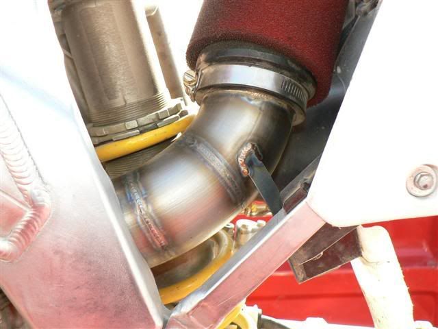

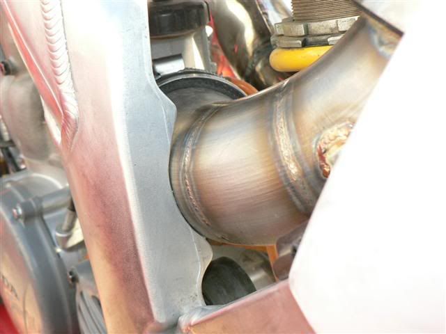

unless you put the green sticker from your green sticker bike on a piece of plastic and zip tie it to the suspension of whatever youre ridin with a sparky. i finally photobucketed the deal so heres what i got.....
