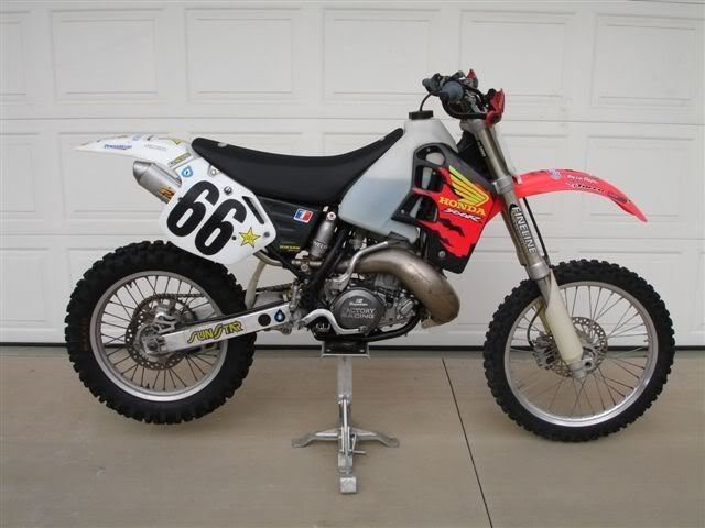

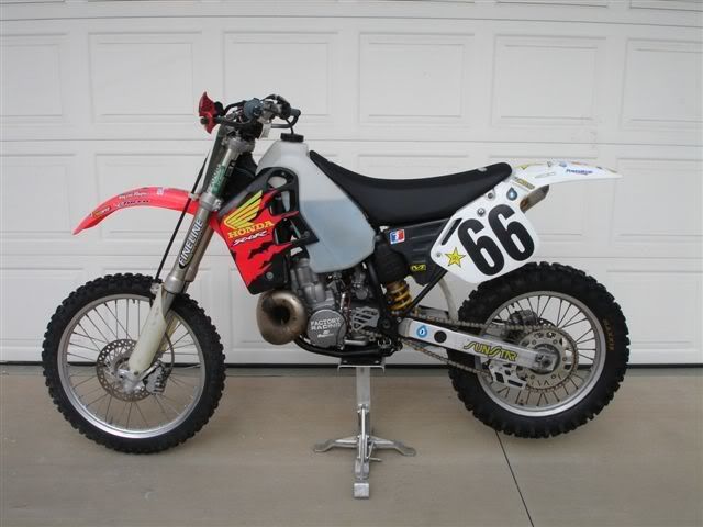

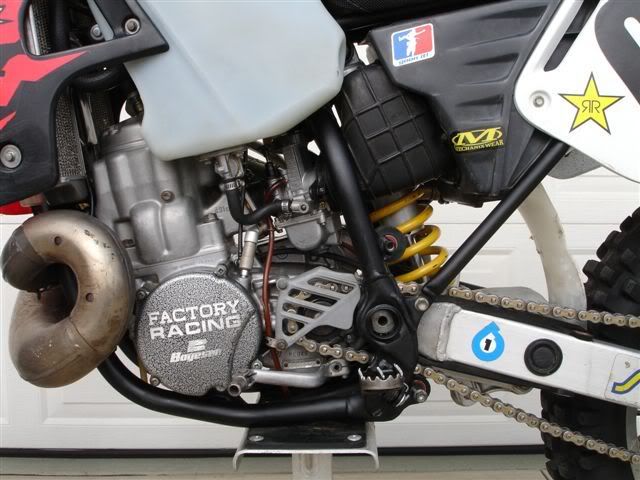

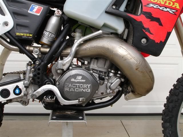

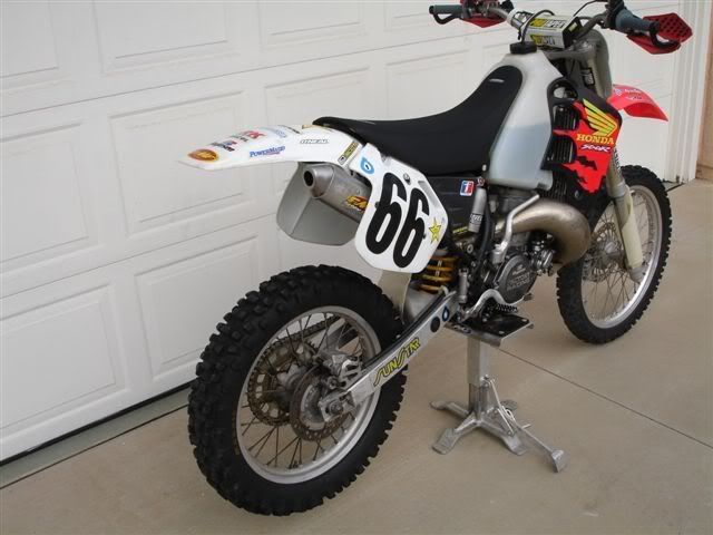

Well I finally got a hoon machine today. I picked up a pretty sweet bike, paid 1800$ but I think it was worth it.
Freshly powder-coated frame also. Runs and shifts like a bandit! Had to travel 2 hrs. to hunt her down. Tell me what you think! First thing Im gunna do is rip off all those gay stickers.

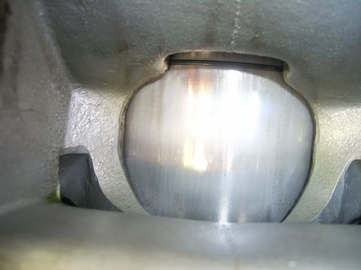

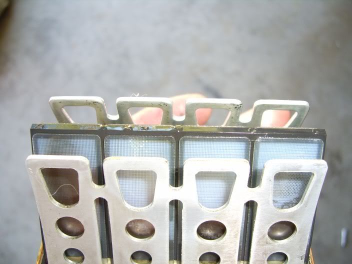

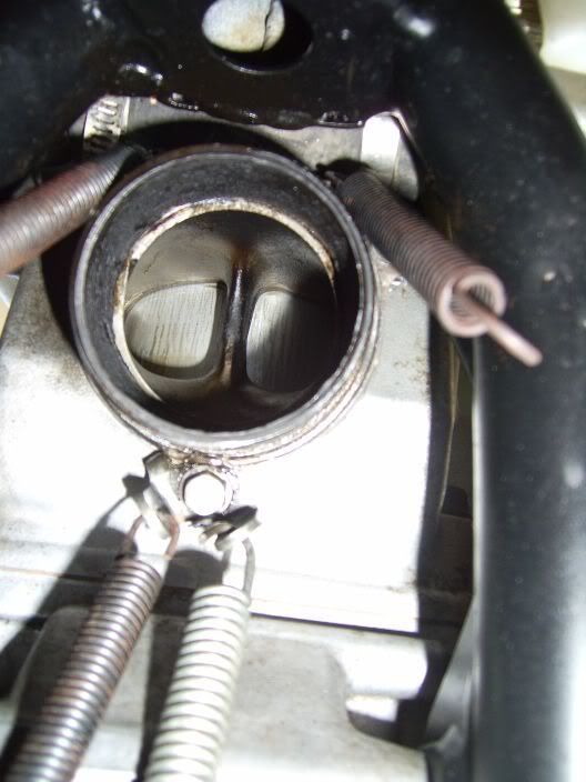

I didn't really notice it last night when I bought the bike, but the lower end has some kind of knock. Its kind of loud and sounds a bit like a diesel. Is this normal?
Here are some pics of looking through the intake & exhaust and reeds too...Clean bill 'o health. It looks practically new. Machining marks and everything.
They all make a horrible lower end noise, its nothing to worry about.
britincali wrote:They all make a horrible lower end noise, its nothing to worry about.
maybe yours does. i dont remeber hearing a horrible knock in mine :rotfl: . maybe it was them fried clutch plates :rotfl: . j/k man
If you dont think these bikes sound like shit close up you need a hearing aid.
