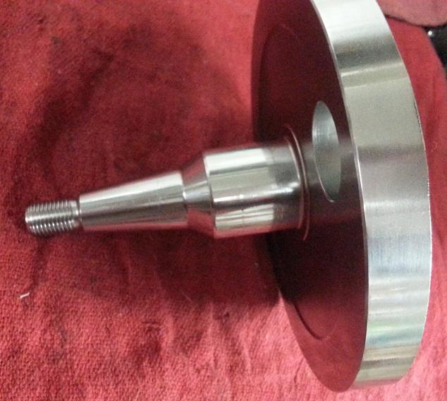

Any good? I remember there being an issue with them discussed on here years ago. No dice on finding the thread. The prices for a complete crank, main bearings, and all bottom end gaskets/seals is around $300 bucks, and the cranks alone run around 200. I would imagine the local shop (PR Racing) would be around 200 to rebuild my old crank, waiting to hear back for sure.
I just dont want to buy something sub-par.
Rebuild your stock crank with a Pro-X rod kit, do not use the Hotrods crank assembly unless you weld the crank cans to the crank wheels.

had the stuffer fly off one with less than 10 hrs on it

And while your there, make em look purdy.. :cool:
http://www.oem-cycle.com/forum/download ... hp?id=3810
