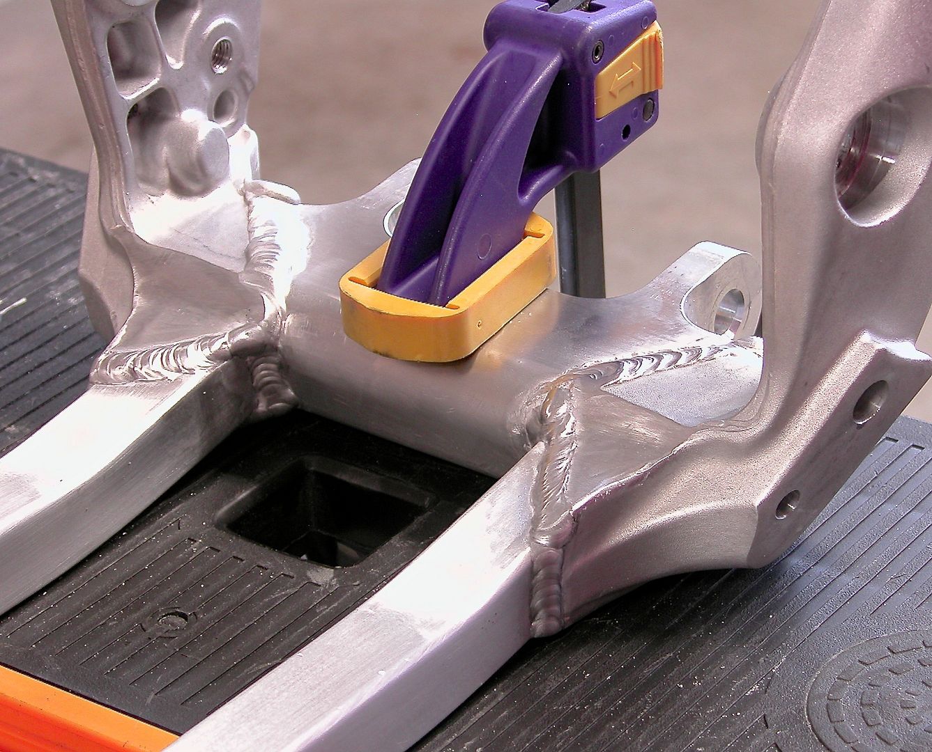

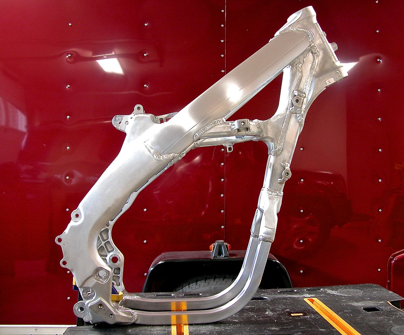

I welded this frame cold with a Lincoln Square Wave TIG 185. I even used
a pulser to keep the heat down. I didn't use a jig, I just kept the rails
clamped up until they cooled - no movement at all.

What year is that frame? Did you reuse the stock Y?dogger315 wrote:Actually, it's not. Welding on these Aluminum frames is considered prettyOK, I know preheat is needed,
