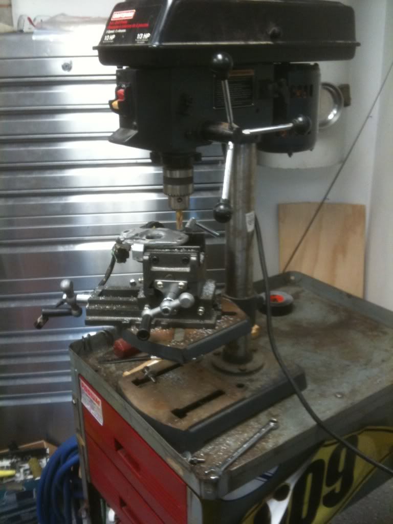

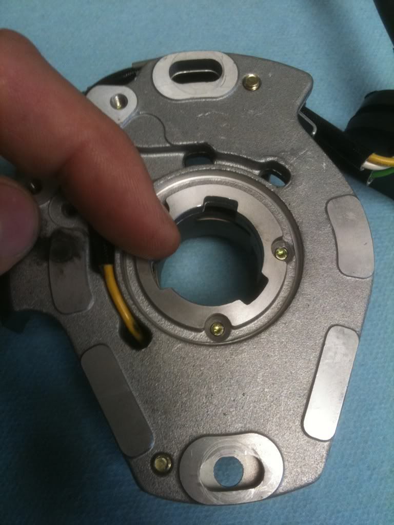

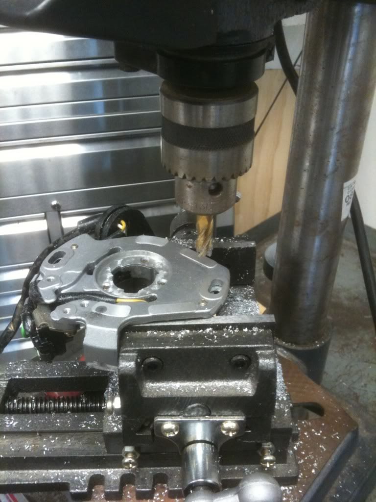

Well I'll take the lack of response as a hint that I should get off my ass and do this with pictures so our community can benefit, I'm not breaking new ground here, and I'm sure there are easier and or better ways about this, any input is always appreciated!!
What you start with (back of the 2003 Cr250 stator) this raised section has to go down to flush with the bottom of the groove
How I removed the raised section, very slowly with an endmill and a cross-slide vise on a Craftsman bench top drill press, using ATF as a lube.

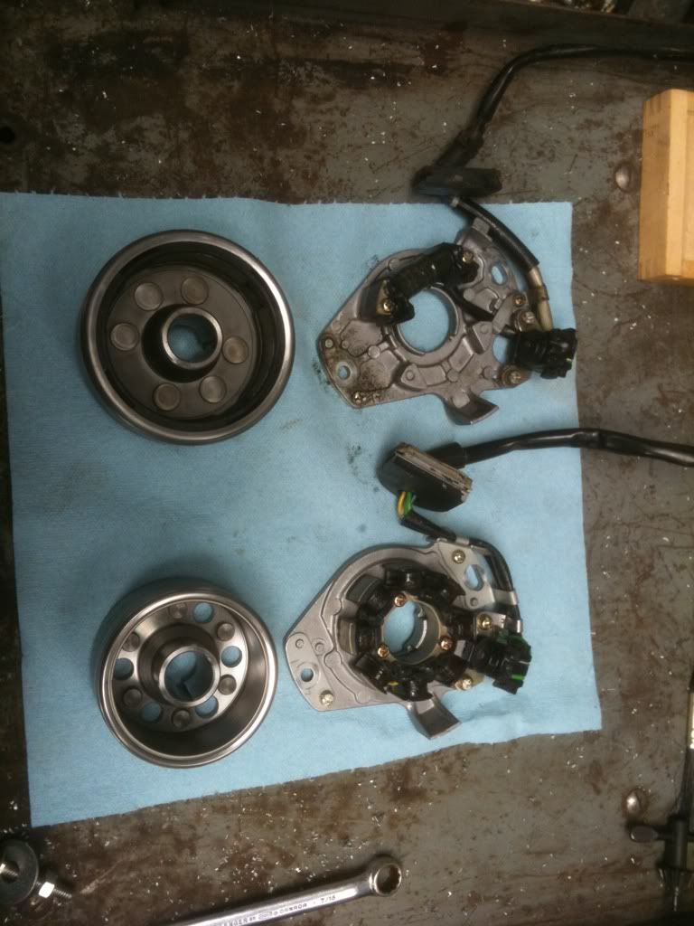

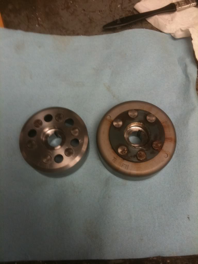

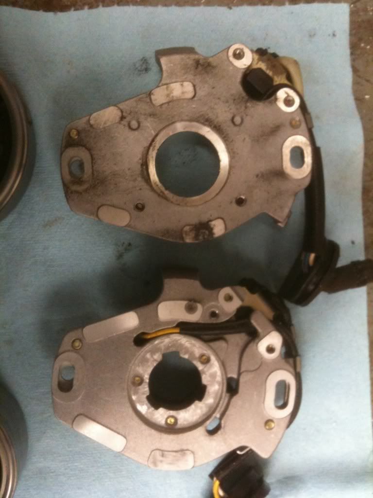

These is the obligatory flywheel comparison photos!
The stacked photo has the Key-ways lined up (by eye as best as possible) and it appears that the timing tabs are almost in line, other than the 250 starts about 1.5mm sooner and ends 1.5mm later. Just appears to be a longer tab.
The stator comparo photos!
So I need to pickup an appropriately sized oring to center onto the crank seal. The 250 stator bolted onto the 500 cases with the bolt heads lined up perfectly to the marks from beig tightened in place puts the case timing tab perfectly in line with the mark in the stator plate, is this how I should be running it? I'll grab more photos tomorrow hopefully I'll have more time to work on it.
