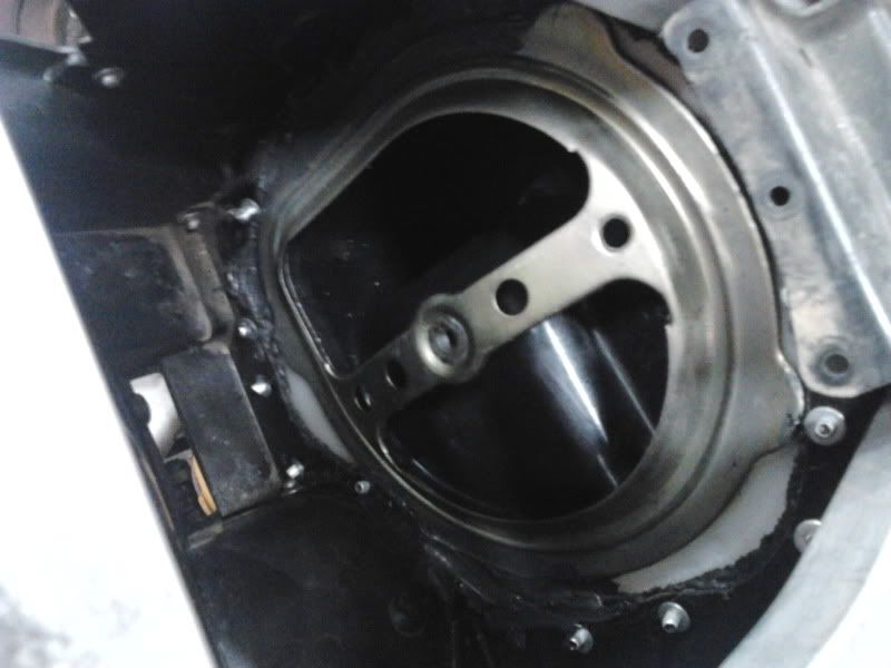

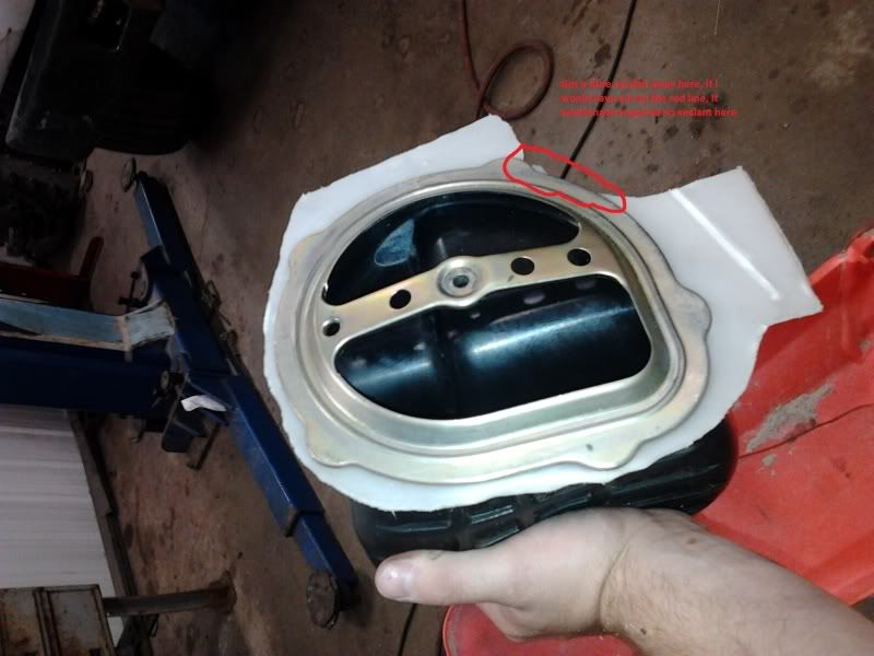

I only wound up with one small hole in the bottom front down by the exhaust that needed to be filled with silicone, when I was shaping the curve in the CR faceplate where the exhaust cutout was, I mis-marked it.

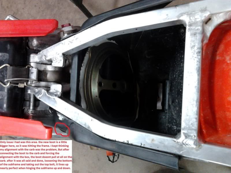

On the left side, there isnt much in the way of attachment, as in order to get the thing positioned in the box, I had to really get the new cage pushed to the left as far as the box would allow (the exhaust cutout in the stock airbox is HUGE).
But, it is sturdy, and pretty well sealed up. But that doesnt really matter anyways. As long as the metal cage is sealed to the boot, and the filter is sealed to the metal cage, no dirt is going into the motor.
