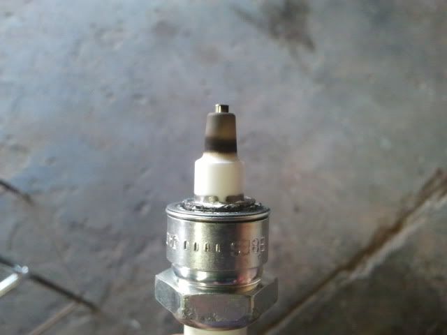

Attached is the plug on a flat speed ride, brand new plug, I know how to do this, as said not the first time.....

what the hell did you do to your spark plug ?

coley13 wrote:what the hell did you do to your spark plug ?
A proper plug chop :D
