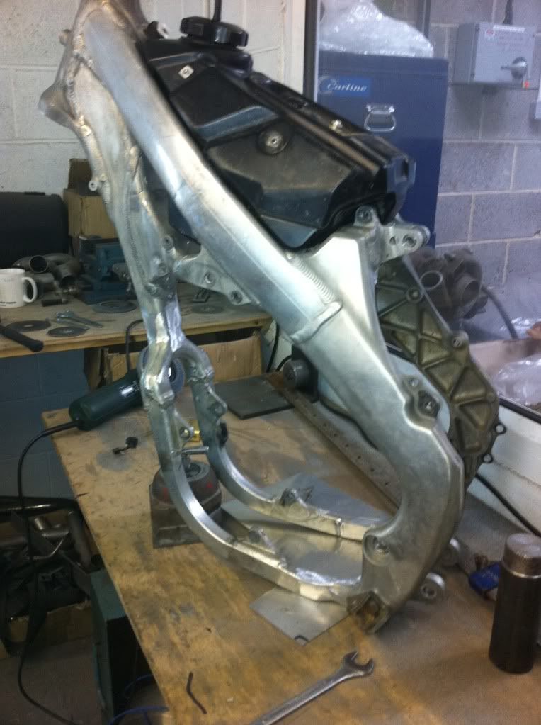

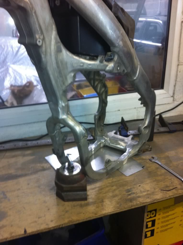

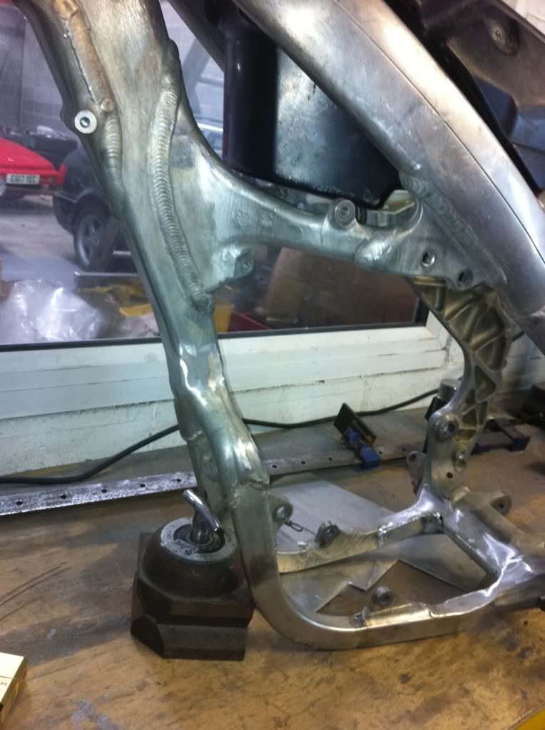

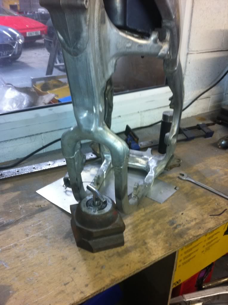

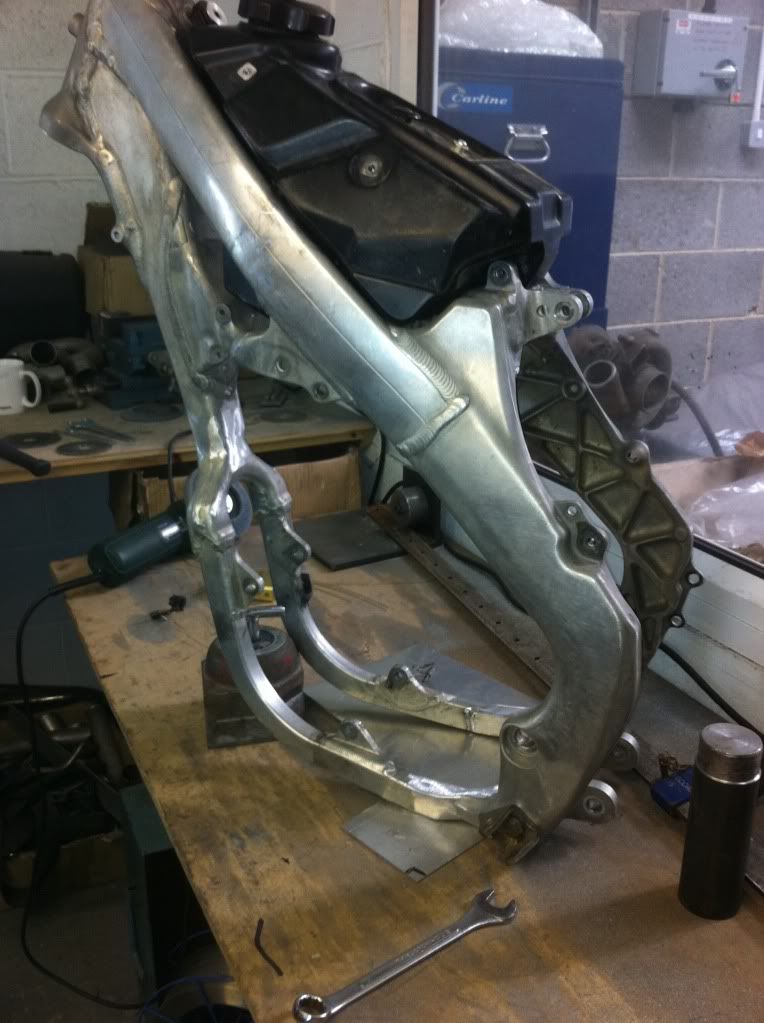

FINCHMAN
Posts: 8
Joined: June 6th, 2011, 12:57 pm
latest frame pics
Post by FINCHMAN »
FINCHMAN
Posts: 8
Post by FINCHMAN »
