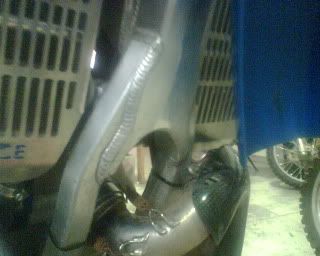

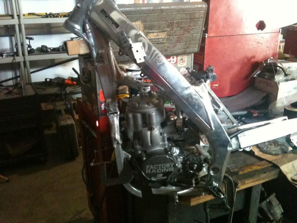

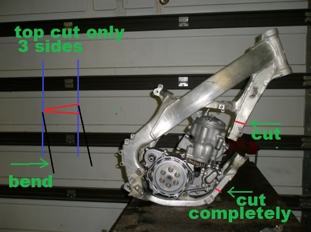

i've pinched a picture from Mad dogs gen3 125 build....
first cut lower rails as per drawing completely and then-----
picture two tiny holes drilled both sides at the rear to prevent cracking and a pie cut to the front and two sides. I've exagerated the picture. Method would be to bend the down dube a couple of degrees further forward and then re weld. This would push the "Y" and lower radiators slightly forward and give engine clearance. I was thinking this would be a stronger section to modify and reweld but not sure changing the "PLANE" would be the smartest move.
Just after thoughts on this, pro's and cons. Would it work or be an engineering disaster.
PS. not interested in anything else "Y" height etc just moreso interested in the structual integrity of cutting and bending a frame in that location and fashion
Anyway, let us know what you think
Edit, just picture that with the "Y" still attached to the down tube

I wouldn't do that if I were you. I had mine done the same way for my 250, got it all together powder coated the frame it was titties! Posted on here and 50 ppl who have done it the same way as me said there y cracked! I took there word for it and now I have to cut the whole thing apart again!
It was pie cut just like your thinking about! It won't work!

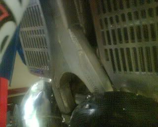

i was looking other pics of 125, sorry i stole this pic aswell. led to believe it failed at the Y too.
Was wondering if these failures are due to the change in angle, hence my thought on changing the "PLANE" Further up from the "Y". The section looks like it would be sturdier.
Or maybe make a DIE and do a slightly curved boxed section using a press "IF" it can be suported. Kind of like cold roll pressing it. Not much room to work with up there though.
Anyway, just thinking out loud. Cheers

Um I thought you were going to cut in to the y and down tube with a pie cut and bend the y foward like your picture??? That's what I did don't do that. Is that your plan?
I'm not sure about a 125 frame... But that angle is extreme...
Hopefully some one will post that's done a 125 frame cuz I have no clue.

basically i was thinking the same, the only difference would be to change the angle further up away from the "Y" section in the beefier RHS section part of the frame.
So the heat effected area is not at The "y"

i've been thinking more of the bending method instead of the pie cut method... I did some rough measurements
20mm forward over 230mm distance. I havnt been to school for 20 years but i worked it out at roughly 9 degrees needed. i could be wrong
I'd be curious of bending stresses to achieve 9 degress over roughly 4 inches of RHS "thats the distance from the inner support to top of "y" with a gentle radius.
Maybe a better option ?????????????

Dont pie cut anything! Lol that's how I got into trouble!
As far as I know on a 125 frame the y has to be cut completely out of the frame, the down tube trimmed for clearance and the y re welded over top of the downtube.
It's the blind leading the blind!!!!!! Just wait for some one with more knowledge to chime in b4 you hack the frame up.
