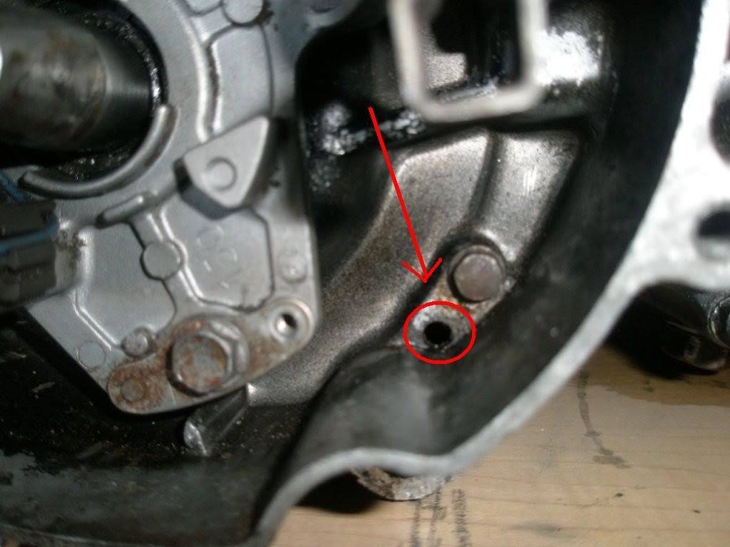

Ok guys, here is the weep hole from inside and out. Theres nothing able to get into it unless it comes up thru this hole.
If the crank case gasket is gone its usually higher and will be burning trans oil.
If the waterpump seal is gone the coolant would have to be 1.5" or deeper to get as high as this area sits, AND the gasket from the trans would have to be blown out to this cavity aswell.
i'm guessing you just have the slimed gunk buildup that happens. brake kleen it out, a little compressed air will either blow it back at you or shove it out the bottom
I have cleaned it with carb cleaner, air, towels. It usually leaks after a hard ride. a few days after the ride, it is leaking again. I know it's coolant on my bike cause it won't burn. it looks like fresh oil or premix if you use a brown oil. I just keep the bike topped off and am waiting for a time and a need to do a full rebuild. I am not worried about it other than it makes a mess of the bottom of the case. the honda service manual says to check that there is no leak from the hole you showed us roostius. but it doesn't say what to do if it does leak from there. when i take off the ignition cover, nothing is in there, so i don't know what to do about it. I hope some of this is helpful to you as well maddog. but i can't figure out what is going on with mine. I don't think i am burnin trans oil. my level seems to stay good.

the picture is from another 500 motor I have in the garage, the motor in question is at a friends house. No oil on the back of the flywheel. 100% sure it is yamalube, not tranny oil. Could be the seal, but it sure seems to be coming out the hole. From Adam's pictures that would mean I have both a leak in a case seal right at the cavity, and the hole at the bottom of the cavity is plugged. Seems unlikely, I'll have to check into it more. Might have to split the cases.100hp honda wrote:your seal is saturated, clearly evident it in the photo. now if you had oily stuff just in the bottom of the cavity then it would be your clutch arm seal. probly had a bunch on the back of the flywheel also..... dead give away. only 2 ways oil can get in there, clutch or crank seal.
