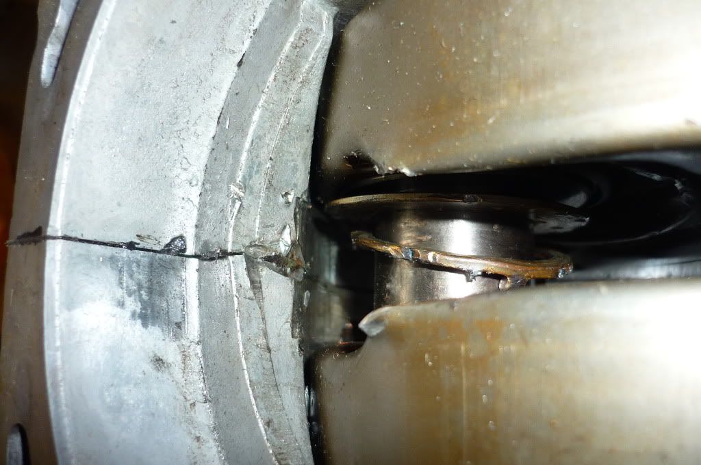

They all need rebuilds, in fact I only have one good motor, out of all 3, and even that one needs a fresh bore.
One has a broken rod and some minor crankcase damage resultant, one has a broken cuntershaft guard, one is a stop sign at 90.5 mm.
The rod takes a vacation....

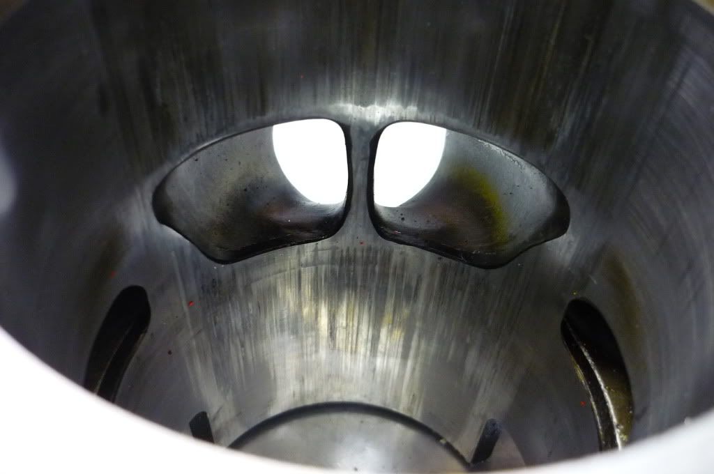

The stop sign...
would have helped if this guy had the right size piston in it... he had a 90.25, and the bore measured 90.5 ~ if I recall right, anyway there was a pile of slop. No wonder the rings were chatteing above the top of the exhaust port.

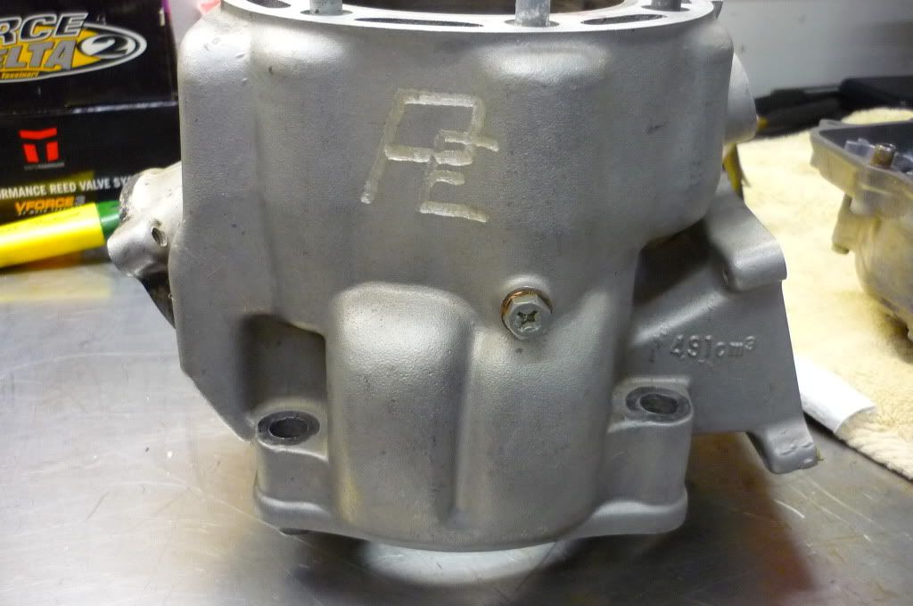

Performance Engineering cylinder... the one with the stop sign.... :evil:
PSI 46MM :shock:
she'll never be the same :wink:

dubious01 wrote:The stop sign...
i was under the impression that one bore-size too small of a piston would not even get any compression? never tried it though LOL..... :shock:
both engines are dissasembled and washed, i'm just going thru the transmissions at the moment.
[quote="dubious01"]The stop sign...
The bore is about 90.35-90.38 oval, I should be able to clean it up at 90.50, i'll confirm that by the end of the day
